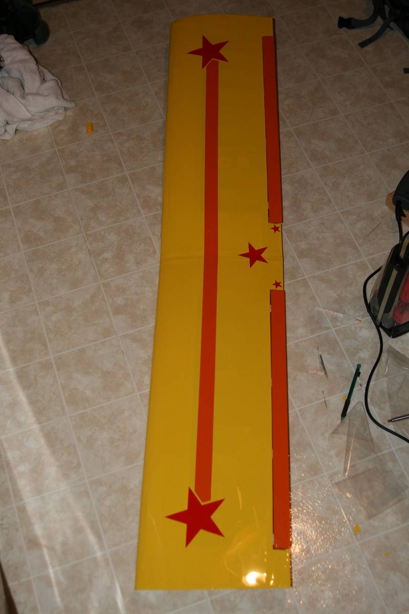

Well the major parts are covered now im working on the control surfaces. This is what i have so far.
john

John... your doing a fantastic job so far! Keep up the good work. Make sure you keep the tension on the Mono... it will keep it from loosening up. Plus with Mono you will want to apply the heat and back off from it and wait... and watch to see if the wrinkles disappear.
With Ultra, I can apply the heat and in most cases it will tighten while I have the Iron on it. Basically Mono is a little tricky, but once you learn to work with it you'll love working with Mono.
If you decide to add any designs or striping, use Ultra on the Mono. You can't use Mono on Ultra because of the difference of the heat sensitivity of the Ultra. Meaning you can apply Ultra stripes with the Iron and it won't effect the Mono... and less chance of playing "Chase the Wrinkle" game. [:@]
Your first covering job looks better than some who have been doing it for a while that I fly with at my club. Matter in fact it looks better than my first airplane. [&o] Take your time.

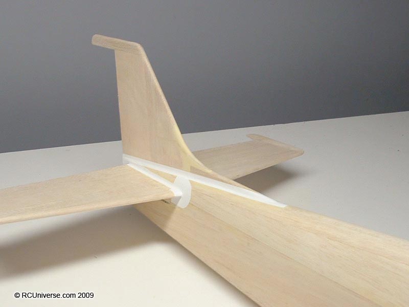

I prefer to assemble first and then cover.
It makes covering a little more difficult, but the end results look so much better.
I can remember when ARFs first hit the scene. Two of the things that just bugged the hell out of me (aside from the poor quality of early ARFs) were the plastic parts (like wing tips, stab tips and a fin tip) that were just glued on after covering, and the big open seam where the stab and fin met the fuse (Due to being covered first and then assembled)
Besides, with MOST kits, assembly is done long before covering, so to cover first would require some re-engineering on the part of the builder.
The trick to covering a plane with installed tail surfaces is to iron a thin strip (About 3/8" ) to the corner first.
Below is a pic of how it's done and a pic of my current covering project with the corners covered
It is also demonstrated in the first video in this article:
http://www.rcuniverse.com/magazine/a...article_id=726
Edit: PS, Although ARFs have come a LONG way in quality, they still have those big ugly seams where the stab and/or fin meets the fuse. To me, covering after assembly is a "Badge of Honor" so to speak, that shows it was BUILT and not just ASSEMBLED
