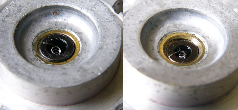

So what is a 'hot' plug, and how does it differ from a 'cold' plug?
Naturally, a hot plug will heat up faster and stay hotter, but that's not the whole story. When discussing this aspect of glow plugs, another very important aspect must be considered, the amount methanol in the fuel. The more methanol we're using (i.e., less oil and less nitro), the hotter the plug we should use. Conversely, the more nitro and/or oil we use, the less methanol we're using, so we use a cool(er) plug. An extreme example would be when using a very high nitro content fuel in a very high RPM engine (a typical ducted fan engine, for example). Here we'd use a very cold plug. For most sport pilots using fuel with just 5-15% nitro, however, a hotter plug would probably do well.
Probably? Yes, trial and error is often the best (and sometimes 'only') way to determine the right glow plug for your application. Most 4C engines need either high nitro or hot plugs to run at their best, since they have combustion strokes only half as often as 2C engines.

From left to right: Stock Evolution 1.00NX 2 Stroke Glow Plug O.S. "F" 4 Stroke Glow Plug Stock SuperTigre .75 2 Stroke Glow Plug O.S. A3 2 Stroke Glow Plug
