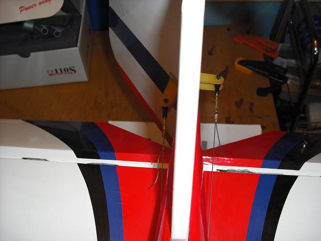

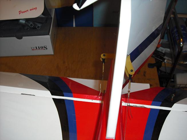

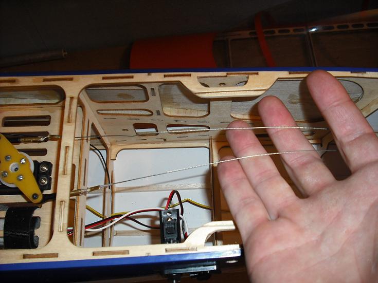

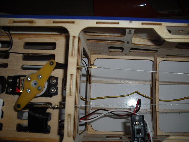

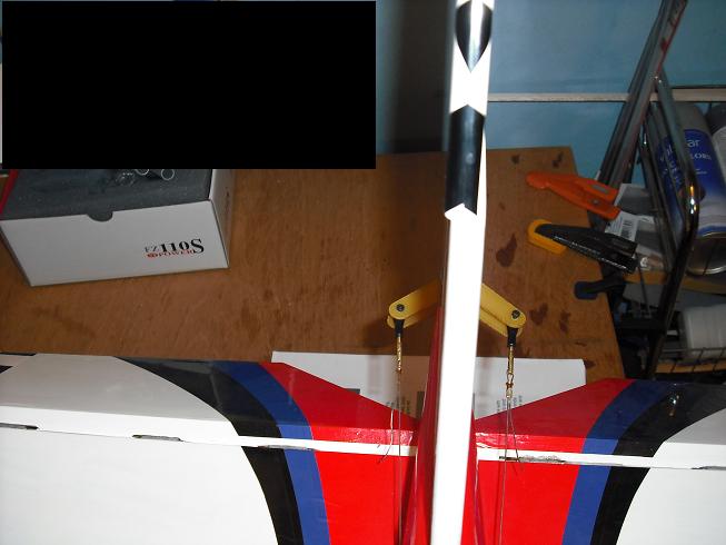

My instructions don't talk much about tension, and I think that's where my problem is but I'm unsure. How do you set the tension?
When the rudder is neutral, cables are snug but not overly tight. When I input left rudder, both cables end up loose, and the return to neutral is very jerky. When I input right rudder, both cables remain tight throughout the range of motion, and it is very smooth and accurate. There is enough tension however that the surface the servo, battery, and receiver are mounted to flexes with right rudder, though not too bad.
What do I do? Here are some pics of neutral, left input, and right input, respectively. You can see that the servo horn has a slight amount of Ackerman as the connection points are aft of the center screw. The lines cross inside the plane.
Please help!! Thanks.

Can you shoot some pics of the rudder end?

How's this? I tried adjusting one of the ball links before which is why you see the rudder not centered perfectly. A click or two of trim centered it again, same operation issues.

You must have the pivot points (if establishing positive Ackerman at the servo end) ahead of the pivot point of the servo arm. If establishing it at the control horn on the moveable surface, then the attach points must be aft of the hinge line of the moveable surface.. You want the lines to be barely snug at neutral with the line not being pulled going slightly slack as the surface is moved off neutral. If you get negative Ackerman by doing the opposite, you get in trouble fast as the line become to tight and can cause binding or cause excessive servo current drain.

The center of the attach points on the rudder horns are even with the leading edge of the rudder, so either at or just barely behind the pivot point.

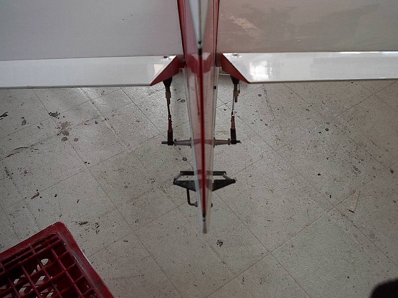

OUCH! I found an issue. The rudder horn on the left side is longer than the one on the right side. Regardless of where the pivot point is on the servo, left rudder always ends up in more slack.
The hole in the rudder horn on the left side of the plane is 1" from the rudder, while the hole on the right side is 3/4" from the rudder. The rudder horn is one piece that slides through the rudder and is epoxied in place.
What I see my options as being are:
1) Drill a new hole at the 3/4" mark on the left side, trying to keep the hole the same distance fore or aft of the hinge line. My question here is about uncertainty of PC board strenght, drilling, and plugging the old hole.
2) Cut off the existing horn and try a new style. Issue here is the existing cuts and parts epoxied in the rudder either being in the way or weakening the attachment point.
3) Somehow modifying either the servo horn or adding some kind of tensioning device.
I like option 1 but would like to hear some comments (especially on drilling and plugging holes in PC board horns 1/4" apart).

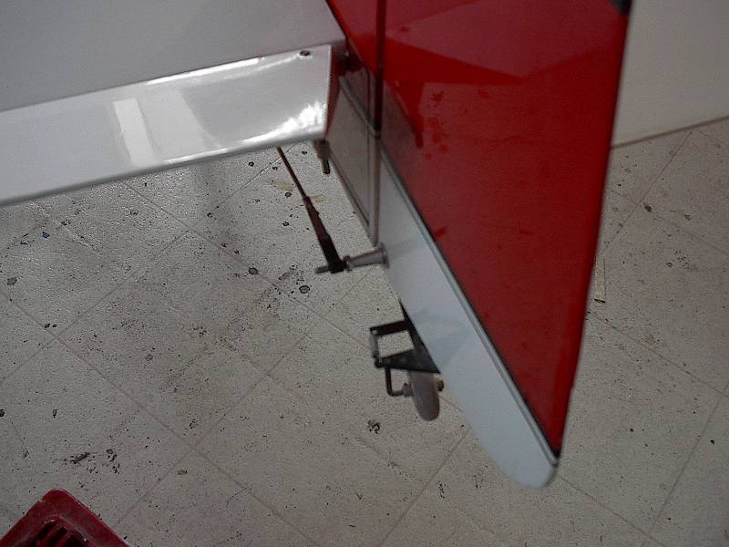

Well Joe, that really sucks but it's one of those little Nitroplanes things I mentioned. Other then that those look like pretty good little items. On most ARFs I tend to use after market hardware unless it's one of the higher end planes but then you are paying for it and the ARF will cost you a lot more. Wild Hare gets about $75.00 for there hardware package for there big planes and look at the price for a Horizon ARF, they usually have very good hardware but you pay for it. Time for you to start stocking a building box of your own. The photos show one of the items I use for my pull/pull systems, I think it is Dubro? I keep several sets of different sizes on hand. I make up my own pull/pull systems too using stainless steel plastic coated fishing leader of different sizes too. I would just remove the horns you have now and install something like these. I also make these up myself too sometimes using 4-40 all thread, not very hard to do. If you have some old plastic control horns around you can use those too and just screw them on from side to side. Unless you can get the wires even you will never get the system to work correctly.[&o]

You may not be able to get it off clean but if you have a heat gun you can get the epoxy real hot and it will peel off sometimes. See, heat transfer!! Try not to over think this. On a pull/pull set up you want the servo arm to be even and you just go into sub trim and move it until the arm is centered. If your servo arm is one inch long you want the wire at the rudder to be at one inch long. If you have a nice straight shot for the wires then you want to connect them so the wires are right side on right side and left on left. If not then you can cross the wires. Sometimes you will just have to live with one wire going slack while the other is tight but if done correctly they are both tight when the rudder is deflected. That's in a perfect world but with an ARF sometimes you just have to live with how they have things set up and it's out of your hands. When I build a plane the set up is always on my mind and I build with that thought in the back of my head so things go smoother for me in the long run. Now if I could only remember to install the servo wire tubes in my wings before the wing is assembled.

I see a couple of misconceptions in some of the above comments. First off, you are better off with some positive Ackerman in any pull-pull system and that means that the line not being pulled will slacken off a slight bit as a control surface is moved away from neutral position. The second one is that the length from the hinge line to the attach points on the horns must be the same as that on the servo arms. In fact, you can have the horn lengths as long as you want with no problems other than reduced sensitivity. There is a limit to how short they can be though.
as long as when the servo is at full deflection, the moveable surface is not moved beyong the limits of the hinge line, you are perfectly safe. Another popular misconception is that the run from the servo to the horns must be perfectly straight. Not at all true, if you use the proper guides you can turn them 90 degrees, route them around obstructions or most any other shape. Real planes have been doing this for ages with no problems and I have at least 10 large scale planes that I route cables around structure with no problems. Once you do a few pull-pull systems, you will never use push rods for the bigger planes or where minimum control slop is allowed. Probably the biggest mistake I see in most pull-pull systems is to tight a tension on the lines. You want just enough to prevent any slack in the neutral position.

Well before starting to cut things up (and of course studying my Heat Transfer...after this, I swear!) I figured I'd try re-drilling the rudder horn. Now the two attachments are within 1/32" of each other, laterally and fore/aft.
Things are looking a little better. I still get more slack in the system when I use left rudder input than when I use right. I tried moving the points on the servo horn in and out, and fore and aft. Not much difference, although enough to decide I don't want the servo horn in front of the servo pivot.
How much slack in the system should I be getting when turning? I'm at a bit of a disadvantage having never really seen a pull-pull before.
Maybe a new set of horns is still the way to go for in increase in adjustability?

Most systems will have a little slack on one side during full deflection. Unless your geometry is perfect this will happen. Most times it's not a big deal. When the plane is flying the wind will keep tension on the deflected side. Have you tried crossing the wires? This will help under some circumstances. As far as tension when centered. To much is worse then not enough. To much will wear out the servo and could cause a drain on the battery. Wearing out the servo is the biggest issue.

Ok, thanks. There may be too much tension at neutral, and going from deflected/slack to neutral the servo starts fighting itself? It's really 'jumpy' as I let go of the control, and the tail shakes as the cables bounce around.
