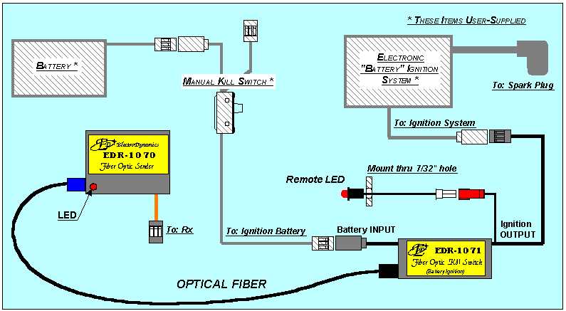

Hi, Installing a G20 on a F6F Hellcat 60. Was told that when using gas engines that you could have radio interference problems. Also that the G20 is power hungry. Here is a photo of the system I would like to use. Question is. How good is this setup.
Thanks for the Help

You do not want to power your Rx with the same battery you're using for the engine ignition.
Think about it: If the engine burns up its power, it will loose RPM or quit - bit as long as it is using its own battery, you'll still have control. If they share a battery, you may lose control before the engine quits.

Is there anything in his setup suggesting that he is going to use the same battery...? I believe he has only mentioned the ignition system. OTOH, keeping them separated is definitely good advice.

Yes, look at the setup - one battery is powering both

Sorry if I'm slow, but I can't see a receiver at all in his drawings. The only thing I can see that has anything to do with his receiver/servo circuit, is the connector from the optical kill switch to the Rx, but this doesn't cause any interference.

The RX system will be separate from the engine system I will be using two batteries.
Batt #1 RX 5cell 2000mah
Batt #2 eng. 4Cell 2700mah
This is what I came up with in doing research on the G20 in the Hellcat. Just won't to make sure.
Thanks the advice.

The electrical hookup looks ok. The only thing that doesn't show up in diagrams is that I beleive that you need to have a metalic surface on your firewall. Something like copper or aluminum foil epoxied to the front. Also you don't want a metal clevis or pushrod going to the throttle. Last point I beleive the fiberoptic sender goes in the fuselage with the receiver, and the kill switch goes in front of the firewall with the engine ignition battery and ignition.
One last thing, you didn't mention what radio you are using. 2.4Ghz are not as sensitive as the 72Mhz systems for interference from the engine.

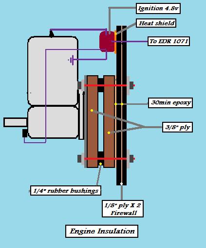

Old 01-25-2009 | 10:16 PM
flystright's Avatar
My Feedback: (13)
Joined: Jan 2009
Posts: 307
Received 2 Likes on 1 Post
From: Rush, KY
Default RE: G20 Engine
Question what servo size do I need for the throttle. Here are some picts on how to mount the G20 and the type of servo's I will be using. If you see something that will not work please speekup. When I finish doing my home work on this plane I will be posting my first build on line.

Any servo will work for throttle
Old 01-26-2009 | 11:18 PM
jrcaster's Avatar
Joined: Sep 2006
Posts: 919
From: Hopkinsville, KY
A standard servo should work for the throttle. What radio are you using for the plane? From what I have read you need to set up a failsafefor gasoline engines. That would mean a PCM for 72Mhz or about any 2.4Ghz. The copper or aluminum on the firewall is for interference. Minnflyer knows a lot more about running gasoline engines than I do, so it may not be necessary. Just do a range check both without the engine running and with, and if you get interference with the metal shield would be necessary.
If that is your version of a vibration mount in post #13 you will also need rubber bushings behind the firewall under the flat washers. Also make sure to use nylox nuts so they won't vibrate loose, because with the rubber vibration damping you don't want to tighten the bolts down much more than snug.
When you hook up the kill switch with two modules the kill switch goes in front of the firewall, and the sender goes behind the firewall. They are linked through fiberoptic cable which will not transfer interference.
