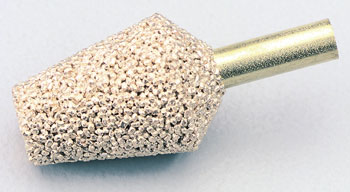

Excessive vibrations will cause bubbles to form... does your fuel tank have padding around it?
Also these help a lot:
[link=http://www3.towerhobbies.com/cgi-bin/wti0001p?&I=LXXF25&P=ML]Click me![/link]

Yep, those do help. I use them on all of my planes. I simply replace the stock clunk with one of those.
I would also just replace the entire fuel system. When it comes to glow fuel, any pin-hole will cause problems.

Those will help if you have a foaming problem, but they won't do squat if you have a pinhole

Yup, you are so right. I didn't mean to imply that this would fix a pinhole problem, but it would do wonders wit a foaming issue, well, at least it fixed the one I had. I seem to recall that it was on my Tiger 60, but I could be wrong. The tank compartment was way to tight for the tank to be wrapped in foam as suggested in the manual, so I put it on the top and bottom, and then put the anti-foaming clunk in and it all worked.
By the way, the OS ones that was pointed out by opjose are a tad bit expensive. The Dubro ones, although are called something different, work just as well and are quite a bit less expensive, like on the order of about 2 bucks each.
