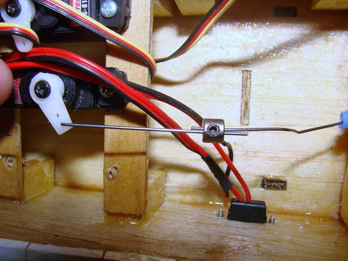

I need wheel collars for .032 wire and the ones in towerhobbies do not specify what wire they will fit.
What wheel collars will splice two pieces of .032 wire together? 1/16”, 3/32”, or 3/16”

Well 1/16" is .0625", so the hole may be slightly larger. Two pieces of .032 side by side is .064", so it's iffy that they would fit. But you could enlarge the hole or just use the 3/32" and a third piece of wire if necessary.

Want them for primary elevator/rudder control for a Micro Telemaster, for easy adjustability.
Plan on Z-bends at horn end, and E/Z links at the servo end, with wheel collars joining the two.

You could use this at the servo end

First, you tell us beginners NOT to use E/Z Connectors on the main control surfaces because the retainers can pop off during flight. And now you are telling me I should use them.

My 2 cents . I have used E/Z Connectors for years. If you use the metal retainers, they are great, just a pain to get on. I still use the plastic retainers and just check them on my pre-flight to make sure they are tight. 95% reliable for me. You just have to make sure they are tight on the post. The main reason that I like to use E/Z type connectors is that I can make any adjustments quickly at the servo, I just leave my push rod wires a little long in case I need it.. Yes, Z-Bends have been used and most folks recommend them. But you also see and hear to use clevis' (which I also use). So, to each their own.

I think the connector I found gets a bad rap. I've used the ones for #2 wire on a 60 size trainer with no issues.
It should work just as well as a wheel collar. Either one has a screw that needs to be checked for tightness occasionally.
