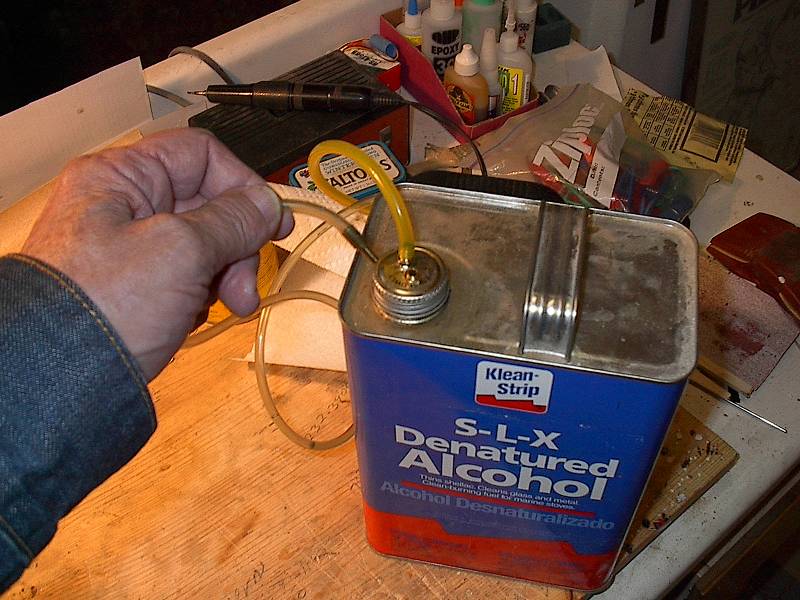

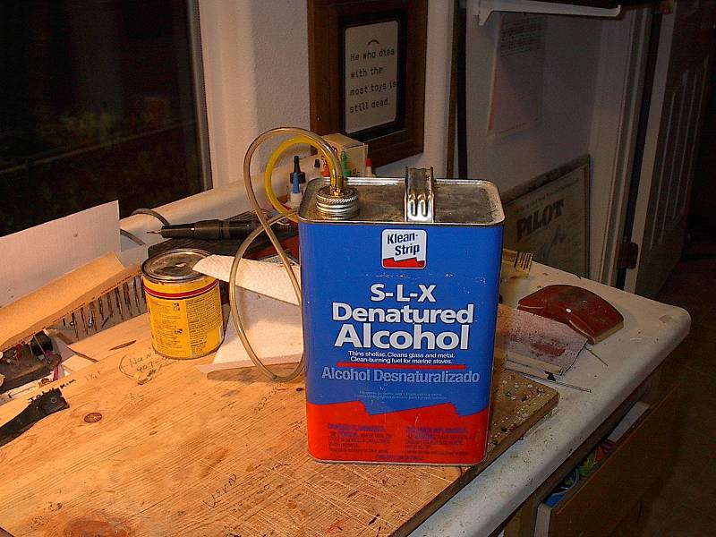

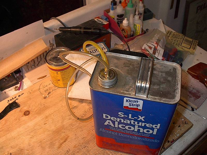

I use a lot of acetone and alcohol so I buy it by the gallon. For me I always get the cans with the big caps then I just buy the fuel can kit for a couple of bucks and it is an easy fit. After use I just leave the caps off of the cans for a couple of days so there is no left overs. I have made up a lot of these for other people with my left overs, sometimes I have a lot of empty cans around. This one shown is for gas and I have another one just like it in my big flight box. I like the plastic one Joe is showing you in the half gallon, it too has a big enough cap. I find the caps on my Power Master cans too small but if you have deep pockets there is a special cap or electric fuel pump for them you can buy so you don't need to worry about filling up your after market can.
ID:	1129801   Click image for larger version
ID:	1129802   Click image for larger version

Good pictures Gray Beard
It looks like you used the Du-Bro kit. This is from their web site.
http://www.shopatron.com/product/part_number=192/101.0
When I mentioned using any solvent, I guess I should have qualified that to any inorganic solvent, since water is also considered a solvent.
But I go through enough acetone that I always have a can or two.
As to plastics, there are too many that are not compatable with glow fuel. Unless you buy a 5 gallon fuel jug from a speed shop that the plastic is formulated to contain methanol and Nitro.

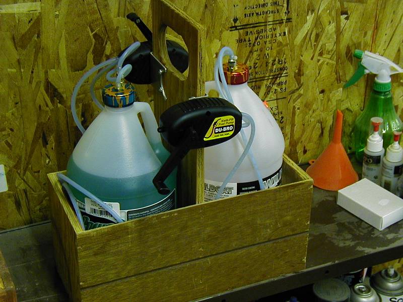

This is the setup I use. Plastic jugs, a separate pump for each fuel. Red cap is 30% for my YS engines, blue cap is 15% for everything else. Works for me.
Paul

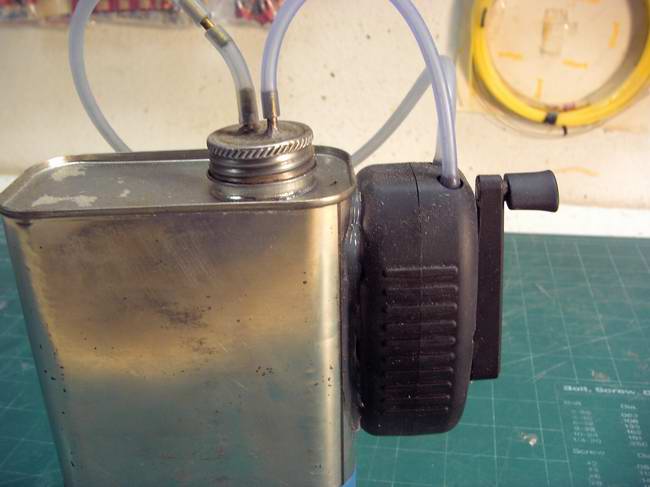

As Highplains and some other have indicated any metal hardware store solvent containers are no problem and require not much more than just being aired out. I have used paint thinner, acetone and lacquer thinner cans from the hardware store and although many no longer come with the large all metal cap some are all metal with serated edge and a plastic safety ring. This can be cut off and the cap can be soldered which I prefer to do for a cleaner and leak proof job rather than the compression thru fittings sold for the purpose (these are particularly leaky when used on plastic caps. This type cap can be seen in the close up picture of the quart can.
I do use Powermaster fuel almost exclusively but do no use their cans for my flightlne cans since these cans have molded and swedged plastic threads on the can and these will gradually losen and leak with continued use.
With the metal can a pump can be attached with a thick layer of RTV and nothing else is required (no straps) and the pump is much easier to use without the attendant wiggling.
John
Warning - Just had a Damn, why didn't I think of that moment.
Thanks John.
John
I agree. The soldered fittings don't leak and last for years.
