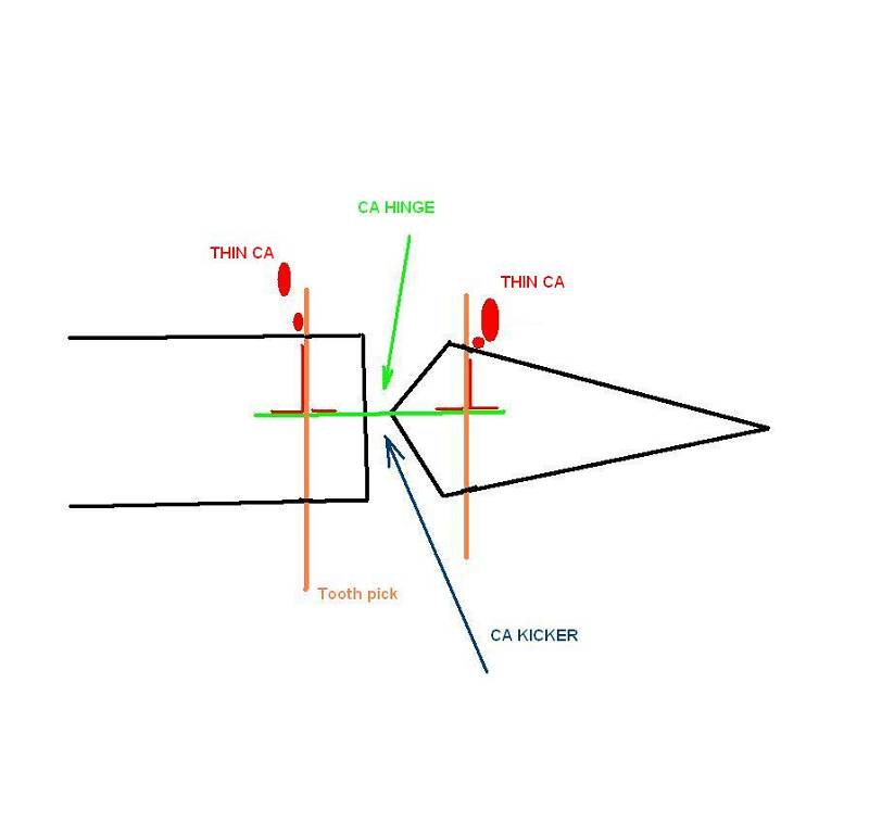

I have a little bit different method:
There is a slot for a hinge and the hinge is sitting inside.
I push a pin through the surface and the hinge to hold it in place for the right gap between the surfaces.
No CA yet, i drill through the surface through the CA hinge with a drill bit.
Then I insert a tooth pick all the way through.
Spray some CA kicker on the CA hinge from the exposed section between the surfaces.
(can do without the kicker as well but you need to play with the surfaces while the CA is curing)
Then I drip thin CA through the tooth pick!!!
I play the surfaces just to make sure they move freely every few minutes for about an hour.
I cut the excess tooth picks and sand flash.
This way I prevent from the CA hinges to harden from the CA and brake.
This method is good for hinging first then sanding and covering over the hinge line.

yes you can do without the kicker as well.
i just dont like to apply CA through the 1/8 drilled hole into the TE, it makes the CA harden the hinge and then it takes me hours to soften the hinges.

My question is whos right ?
Your method has its merit, but you DO want to do this as quickly as possible. Which I why we usually say, "4 or 5 drops of CA"
Obviously (Or maybe not so obvious to some people) if the CA is running all over the wing, you're using too much. But if all is right with the hinge, the slot and the wood, the hinge should easily soak up several drops.
But you have to remember, when dealing with the masses, you have to take into account that not everyone reading an article will be as astute as you are. So generalizations are usually necessary for the "Rest" of the people.
