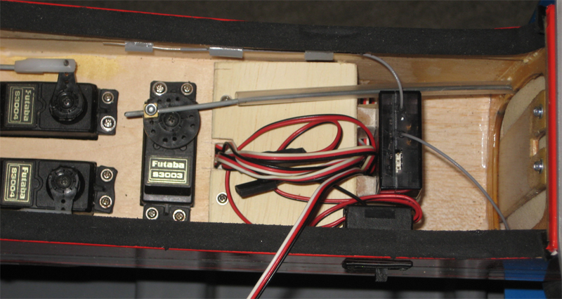

One thing I noticed from your picture is you have your antennas are routed parallel to each other for close to half of their length. I don't fly Futaba 2.4 but Spektrum, and I make sure my antennas are routed perpendicular to each other. Not sure if could contribute or not.

I'm trying to figure out how to manage the space in the plane to be able to do this although the manual states that the part that must stay as straight as possible is the silver tip at each end.

The gray section of the coax can be run together, it is the exposed center that is the antenna and should be separated and at 90.
If it was me I would move the ends away from the servos, they are brushed servos if I am not mistaken.
The brushes if worn may cause excessive sparking under load which may cause RF noise. Random RF noise that close could swamp out the real signal resulting in failsafe, then the servo motors stop moving, the RF noise goes away, signal is now good, regain control. I am not saying this is the problem, just something I would change.
Need more info and debug-testing.

Yes, the idea of one antenna being perpendicular to the level flight plane has been suggested a few times and it's something I'll definitely correct.

How much clearance do you have between the antenna tips and your pushrods? I don't have the manual handy at the moment, but I know there's supposed to be a minimum clearance of around 1/2" to an inch between them and any metal parts to prevent interference. It seems like yours are really close.
EDIT: I had a similar situation on my mid star with everything packed in pretty tight. I ended up mounting one antenna vertically on the fuse former behind the fuel tank and the other antenna was horizontal on the left side of the fuse to keep it away from the throttle linkage in order to get the proper antenna clearance.

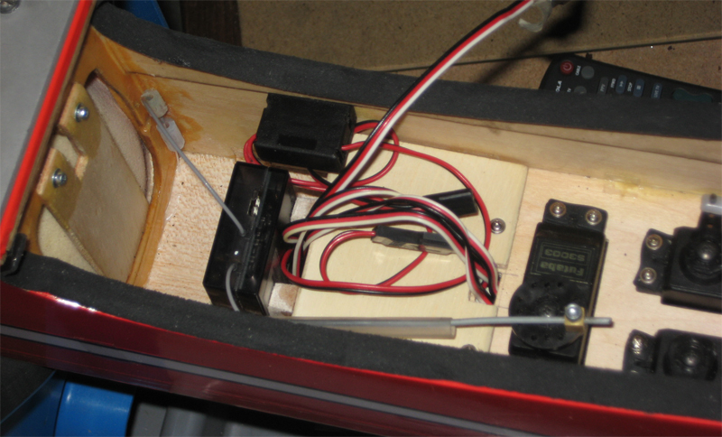

I've done all my radio setup again inside the plane. The following images show my workaround to the possible antenna blockage. I've placed half the battery under the servo tray and I made a retainer for the battery which I fixed with short screws to the servo tray. It's L shaped just in case it's not noticeable on the pictures so it will hold the battery in place which is still wrapped in latex foam. I re routed the servo cables through the hole in the servo tray and run them down the vertical face of the battery retainer. I glued in place some standoffs for the Rx so it wont crimp the cables. A rubber band holds the Rx in place. Now the important part. The antennas I routed one at each side of the fuse, still at 90° but this time one goes along the travel axis of the plane and the other one is perpendicular to that axis. Any comments or suggestions on the new setup I'll appreciate greatly. (The first picture is the old setup for comparison purposes)

Obviously something happened, you have checked the equipment and found nothing; that leaves intermittent equipment failure or RF interference or it could be there is nothing wrong with the equipment and the RX lost sync with the transmitted signal for no repeatable reason.
While many hail spread-spectrum as the holy graile, the fact is no RF transmission is bullet proof.
These things are very hard to troubleshoot in person much less on an internet forum.
Unplug everything and then plug it back in, replace the switch in the plane, on the TX if the antenna is connected to a board with a screw, loosen it and then retighten it, look at the solder connections .... once you check everything and do a 10 - 20 minute range check the only thing left to do is to send it back or fly the plane again.

It seems to me that the RX could have been exposed to direct vibrations from the frame through the black strap, regardless the foam that may have been underneath.
Try to isolate the RX completely from the frame in the new layout, which I don't see now.
Also, always range check the radio system with the engine running at low and high revolutions, and standing as far away from the model as possible.
I believe you should be careful and prepared for an emergency in the following flights, but not too afraid.
Regards!
