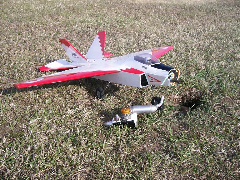

Hi - I have a hangar 9 F22 raptor. the issue is that I want to mount a .61 engine and the bracket for the .61 is too wide for the raptor's firewall. does anyone have experience mounting a bigger engine on this airplane?

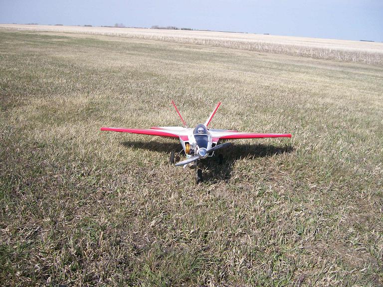

alexedit.... I installed a .61 GMS on mine. I used the Dave Brown round mount BRO 60-70. I redrilled the holes in the mount to match the blind nuts in the firewall. I had to make a small V notch in the edge of the mount so the throttle linkage would clear. I also beefed up the inside of the firewall with some tristock and epoxy. Swapped out the stock wheels with 3" foam all around, put a longer nose gear in out of a Tiger 60, and I am running an 11x7 MAS Scimitar. I use the Bruline filters on all my planes. Keeps the grass clippings and junk out of the carb.
http://www.greathobbies.com/producti...rod_id=BRO6070
Cheers
Curt

Here is a couple more pics of the Dave Brown "quick release" mount!! Remember to always check for those pesky gopher holes.
But you can see how the mount fits the front of the firewall.
Cheers
Curt

Sourkraut - how does she fly with the .61? - do you know if the supertigre61 is wider on the bottom than the GMS.61? - I know this is a hard question to answer, but maybe you know.

As w8ye has shown, the GMS and ST are about the same dimensions so it should work OK. Mine goes quite well with the .61GMS. I might actually try the mod that Minnflyer is talking about. Not that I need more speed but what the heck. Balls to the wall or go home, I guess!!!
