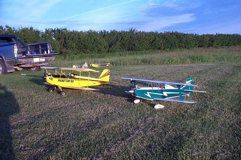

Default RE: longer deflector
ORIGINAL: brett65
I ran clear rubber tubing off the back of my trainers muffler down under the main gear, and it seemed to work great until the tubing fell off. I'm gonna try it again with a nice hose clamp.
You can take some JB weld and make a lip on your muffler tip, let it harden and then slide an extension or tube over it and then use a plastic quick tie to hold it in place. It will stay put permanantly.
My brother and I have both extended the exhaust on our Bipes with rubber extensions and aluminum tube to the landing gear to keep the slime off. He is running a GMS .76 and I was running a GMS .76 and a TT .91 4 st and they all seemed to work well with the exhaust extended. Just got lucky I guess.
