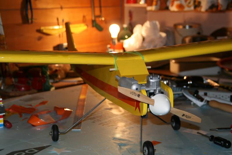

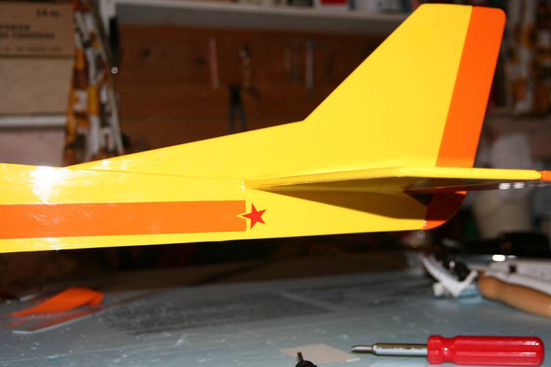

Yeah I built the b wing. I have flown before but it was a long time ago, and I decided a couple months ago to get back into the hobby. My first kit is almost complete just a few more things to hook up then break the engine in. I have already started on a second PT-40 that im making into a tail dragger.
john

I built two of them as well, the first was with the A wing and I did not like the wing, so I bought another kit ($15 more than just the wing kit) and built my second one. I later did a bunch of conversions on the original plane - it earned the name the Basher because of all the mods. I made it a tail dragger, took all the dihedral out of the wing, put an OS .61 in the front of it (it was a .40 size) and extended the rudder and elevator.
