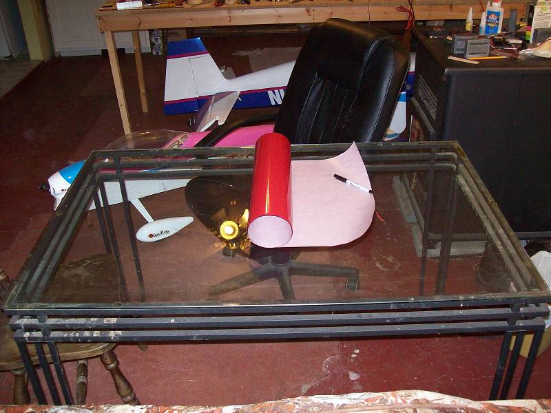

I have a glass top table that works very well also.
