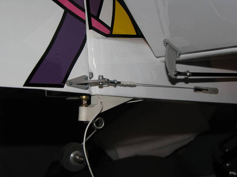

Here is the setup I'm using on my Ruperts Dad. The shrink tubing on the cable ends is just to tidy up the looks and keep the stub from snagging on stuff. The mechanical strength is in the crimp. Make sure you get it really tight.
Don
After I posted the photos, I saw that you are asking about the elevator pull pull. I haven't used that setup as yet.
Don
