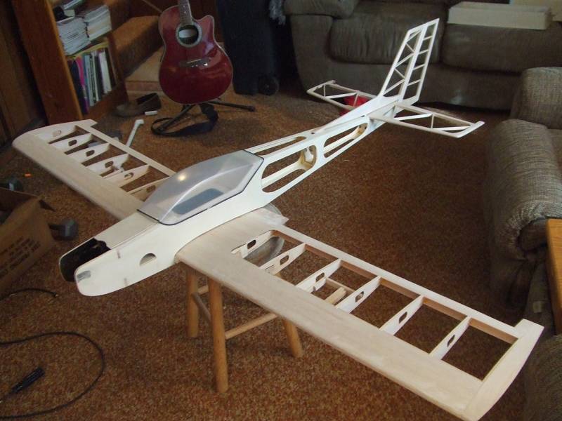

Thats enough playing around with these balancers. Back to work on completing my Tiger 60....
