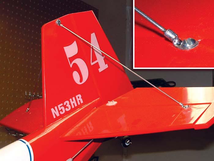

Hi all,
I am experiencing a lot of high speed flutter on the horizontal stab of my wild hawk. I put a piece of carbon running along the entire stab, yet it didn't help. What can I do to remedy this? Thank you in advance.

Other than providing stiffer control linkages and tight slop free hinges there is not a lot to do BUT here is how the big boys do it [link=http://www.fly-imaa.org/imaa/hfarticles/howto/v6-1-36.html]CLICKY[/link]and some large models now incorporate mass balance weights.

This is your best bet

Yes, I was going to ask if I could do that with carbon spars. Thanks!

Yes, it is electric. I have used carbon rods as shown in MinnFlyer's picture.
Sorry, there is no chance that I am slowing down [:-] Half of the joy I get is from the fact that I probably have the fastest Wild Hawk in world at the moment. And even if it breaks into a million pieces, I can buy a new one down the street for 79 dollars.
I have a (5.2mm) x 31.5 carbon rod running through the wings, one running through the fuse, and one running through the horizontal stab, along with the carbon reinforcements shown above in the picture.
