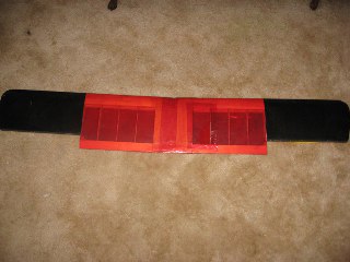

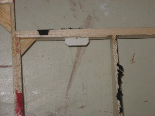

Here is a pic of the wing without the ailerons and a pic of half of the hinge( I went ahead and cut'em) . I thought it was metal but it was just a piece of thin plastic

That's a CA hinge and you can cut it off as described above. Then re-hinge it in a different location (right next to the old hinge is a good spot. Use three or four on each side.
