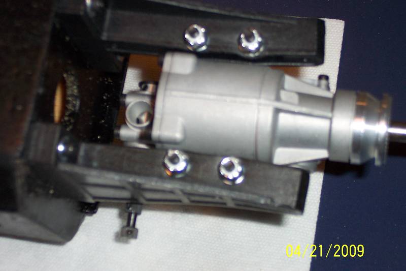

Well I know that I know better than to keep the junk that they include. Take a look at the engine mount and tell me what you think. The sides were straight before I mounted the engine. Should I replace it? I think this will be the last ARF that I'll buy unless it is a Great Planes or top Flite. What good does it do you if you have to spend more money replacing all of the hardware. Anyway please tell me what you think.

Old 04-21-2009 | 09:23 PM
Joined: Jul 2008
Posts: 1,129
From: KS
Default RE: VQ Warbird P51 Dago Red
I'm putting together the P51B and my mount did the same thing, I had down thrust, up thrust, left/right thrust, guess it depended on the angle you looked at it, so I got a dave brown mount and it looks alot better, didn't need shimed
