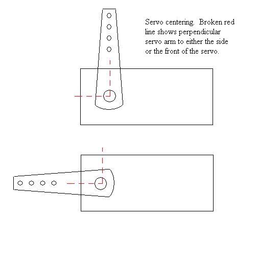

The question is, what exactly do I do to trim it out before the first flight? With the stryker I pretty much do all that in the air after fiddling, but I want to make sure this thing doesn't drop like a rock. I know how to get the COG correct, I'm more concerned with ailerons and the elevator. The elevator especially because it is a split elevator (2 rods from the servo work each side). I can eyeball it pretty well but figured it never hurts to ask a question.

Well, since you didn't heed to advice for a first plane, I won't say a thing about your choice for a second plane.
Mechanical trim simply involves making sure that at zero servo input, with all sticks neutralized including the trim tabs, that the surfaces are straight and flat with no up/down, left/right in them at all.
The way I do that is:
Before going on, make sure your transmitter, if a computer transmitter, is using an empty model with no mix, no enhancements (dual rate, expo, nothing). If it is not a computer radio, then move on to the first step.
First, disconnect all your control rod clevis’s from the control surface control horns.
Next, center servo’s by turning on the TX and RX and putting the TX sticks in the center, the very center.. not about center, but in the center. Center all trim tabs. This is a real important and an absolute necessity. There is no “about†with this. Get them right. If the servo arms are NOT centered, meaning if the arm you are using is not perpendicular to it’s side or front surface (depending on how your servos are mounted), remove the servo arm screw and rotate them until you find the one that is perfectly perpendicular with the side. See the sketch below. Put the servo arm screw back in and tighten it. All servo arms have one arm that, because of the splining of the shaft, will have one that is perfectly perpendicular to the side or the front of the servo. Make sure you do this correctly or you will introduce unwanted differential. Just push it on and see if it is perpendicular. If not, remove it, rotate it to the next arm and check that one.. do this until you have the right one. Turn off your TX and RX.
Next, make two lengths, say six inches, by four inches, of thin ply. Sandwich the control surface AND the stab/wing then carefully and softly clamp this so that it holds the control surface straight and in line with the wing or stab.
Now, adjust your clevis’s so that when you attach them to the control horns on the elevator/rudder/ailerons, you can do so without moving them (thus the reason for clamping the surface in the above step. Once you are happy with this step, remove the clamps. If you have split elevators with two rods, do one side then do the other side. Make sure they are the same.
Now move on to the next control surface and do this one. When you have all of them done, and have removed the clamps, and
Turn on your transmitter and receiver and check movement. Remember, when standing behind the aircraft, right aileron stick moves the right aileron UP. If it’s reversed, fix it!! This MAY result in the necessity of doing the above steps again. (reverse may cause the deflection to change, so go back to the first step, zero the sticks, zero the servo arms, then re-adjust the linkage.
Once you are done all of this, your initial trim settings should be at zero. You are ready to fly it and do the in-flight trim adjustments.

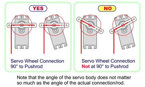

Contrary to popular belief, the position of the arm related to the servo has
absolutely no effect on control surface differential. the only parts of
the servo arm setup that has to be on a 90degree angle is the pushrod to
the arm. A servo travels the same distance no matter what angle it is
installed, but if the pushrod to arm angle is off it will induce a
differential of the control surface deflection. On most of the planes
we see the pushrods are parallel to the servo case, so CGretired's sketch
is very accurate. but I have played with small electrics and a few poorly
built planes that the pushrods were set at wierd angles to the servo
and on a deflection meter you could see that a differential was present.
this was easily fixed by setting the servo horn at a 90degree angle to the
pushrod. I made a slight modification to CGr's sketch to show what I
mean (the blue lines represent the pushrod and the red lines show the angle
between the pushrod and the servo horn).
This same principal applies to the control horn at the control surface.
an optimal setup is a 90degree connection of the pushrod and control horn
continuing down through the hinge line. I have added a picture (I am no artist)

You have to consider that the servo is square in the servo tray which would make it square with the movement of the pushrod at the center or zero point of the servo arm (note Overbored's sketch). That's why it's important to square the servo arm up at zero or the center point as my sketch showed. If it is not square, the arm starts off with plus or minus of the zero point so the arm will move more in one direction than the other, thus differential. So, with the servo zero'ed, and the servo arm square with the servo, the pushrod becomes square with the servo arm and it will move equally as much forward as rearward from center.
So, yes, it matters.
Note that on trainers, with one servo in the center, the servo arm on the ailerons are not square, but they are angled forward (uses the five part servo arms where the two in use are not square with each other but are at an angle to each other, more forward of center). This intentionally induces differential which helps prevent adverse yaw.

it can still be setup properly with no differential if the control rod and horn are at 90 degrees.
I guess I spend too much time with the setup masters.
The difference is incredible when a plane is properly setup comapared to the old good enough setup.
that is the reason Ken, Minn, and others else post technical details and pictures. Because if the job is worth
doing it's worth doing right, even on a trainer or sport model (second plane)
Another pic with proper angles
