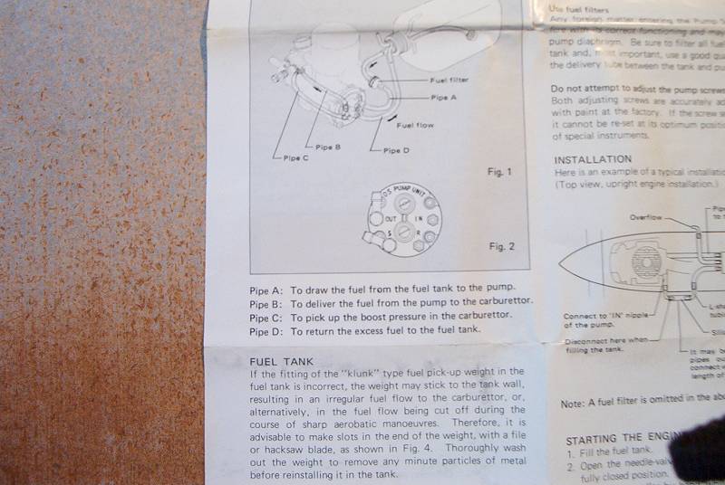

Hello I need help with installing a pump r/c airplane engine pictures would help as well

I'v mounted r/c airplane engines before, I should have wording my post better, I need help with connecting which line goes to the carb, vent and exhaust..im thrown off because the pump has 2 lines attached to the out pump area

bhollo,
Here's the pump manual page on the fuel line hookup. There is no exhaust pressure line, fuel in, fuel return, vent.

If I understand this right, the pump has two nipples to put fuel line to. One is the line comeing from the tank and clunk to the input to the pump. the second line goes to the carb. Its inportant to connect they right.
Not sure what pump you have, but the pump on the K&B .61 said to adjust the pressure richer by truning the screw in on the pump. It was backward from the needle valve for the carb.
Not saying yours is this way, its just the way the K&B was.
