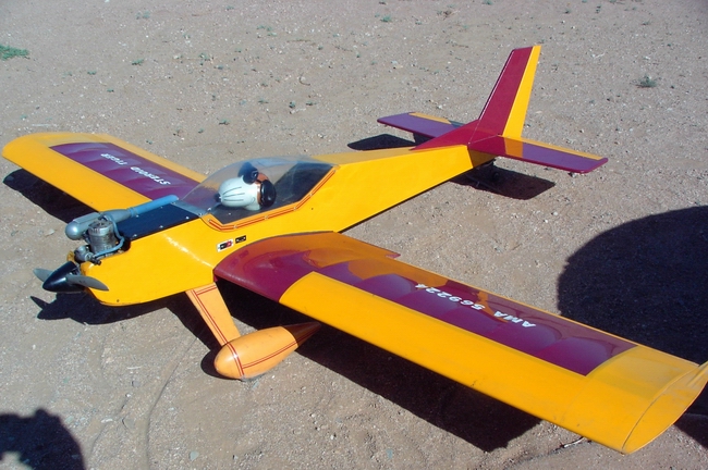

cant get an asp to run right will run for a few minutes an quit any ideas on what i can do?

Mine was tamed with two head gaskets and no more than 10% fuel:

The ASP 108 is designed to run on FAI fuel (no nitro). If you put a 2nd headgasket in the engine you will be OK on 5% nitro (MAYBE 10%)
