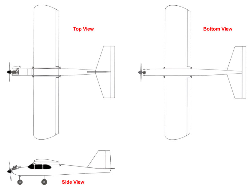

RCKEN & anybody interested:
Here is my effort to take the 3D drawings of the LT-40 and layout a pattern with colors using Photoshop, which I admit to not being very good at. If I got the images attached right to this posting, any ideas or suggested changes are welcomed. I plan on using transparent Ultracote on the yellow wing & stab panels (also vertical stab not shown), Cub Yellow Ultracote on all other parts (i.e., fuse) & Dark Red Ultracote where indicated on wing & stab, with a similar red trim on the vertical stab and rudder. Probably will also add a thick red pinstripe over the cowling and down both sides of the fuse, ending before the tail feathers.[img][/img]
RCU Forum Manager/Admin
It's a good looking scheme, but I do have one suggestion. Make the bottom of the plane different than the top of the plane. Right now there is no way to tell which is which as they are identical. This can be a killer in the air if you can't quickly tell which is the bottom and which is the top.
Ken
Ken
Yeah you can get into quick orientation problems when the top matches the bottow. Some good bold contrasting stripes running from the leading edge to the trailing edge would be good.

Would it work to do something like transparent green on the bottom instead of the transparent yellow? Or dark green trim instead of the dark red trim around the transparent yellow on the bottom? I am only trying to keep as much of the interior wood work visible as I can, because it is such a beautiful kit, if I don't screw it up too badly. I first thought about green trim on the bottom and red on the top, but then thought it might be a bit too much (look like a stop light). On my Alpha, I put multicolored stripes on the top and checkered colors on the bottom, and it really helps me to see it, besides being a big plane (but no transparent covering needed or wanted). I'm also thinking of making the shapes really more different on the top than the bottom, but I know that color differentiation is much easier to see than anything else. I suppose a simple solution would be to run a couple of stripes (red?) right in the middle of the lower wing so as not to spoil the appearance of the upper wing, but I really don't want to do that if I don't have to. How do the big Sig Kadet flyers differentiate their top and bottom views, or any other big trainers for that matter?
