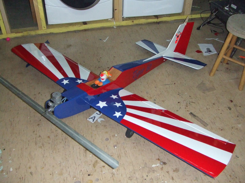

I'm finishing up my Tiger .60 kit.
Before I drill into my engine mount....
Plans call for a 2 degree engine thrust.
I've bolted a 42" piece of angle aluminum in place of the prop.
I have one bolt holding the engine on and the mounts are jast far enough apart to allow me to rotate the engine slightly.
With the engine rotated to achieve the measurements in the photo, I'll tighten the one screw and mark and drill the other 3 holes.
This should give the engine the 2 degrees right thrust relative to the lead edge of the wing.
Does this look correct?
Steve

Popriv, that looks like a lot of thrust. I use a piece of string from end of prop to horz. stab and get 1/8 inch difference. Get good results. Works for me.
I would mount the engine square in the mount. Then, I would use a craft stick behind the mount, sandwiched between it and the firewall. I think that 1 stick would get you in the ball park. Then, fly it and test it to see which way it falls off in vertical stall, and compensate that way.

Instead of doing the math, I just use a cheap protractor and draw the angle on a piece of paper using the actual prop size. Then measure the distance from prop tips to the wing leading edge on the drawing and transfer the measurements to the airplane. Works well for me, but downthrust is a different story. I use a bubble levels and angle scales for that.

The easiest way is to use an incidence meter to set stab, wing, and thrust settings. An incidence meter is a good investment having been a great tool for me for years once I realized its true values. You can setup thrust lines using a level and a protractor albeit more difficult. Building them straight from the ground up certainly results in more enjoyable flying.
Your on the right track in getting your airplane setup correctly. Personally I try very hard to get everything setup mechanically correct first before ever going to the computer mixing. Centering the trims via linkage adjustment as much as possible to ensure the greatest mechanical advantage for the servos. Take your time use the trimming information above taking everything one step at a time. Test fly between changes being sure to take notes as to what you have changed and how much so a change can be easily be lessened or reversed. Your end result will be a good flying machine.

This is how I arrived at those measurements.
Using Illustrator I drew two horizontal lines 11.25" apart. (this is the distance from prop to LE of wing) The top represents the prop and the bottom line represents the LE of the wing.
The prop line is 42" long only because thats the length of the aluminum I'm using.
Then I select the top line (the prop) and apply a 2 degree rotation to it.
The left side of the line moves away from the LE and the right side moves towards the LE. The drawing in Illustrator is full size and I can take the measurements from it.
Looking at the engine it seems extreme to me and I dont want to drill until I'm sure.
I'll double check with a protractor and go 2 degrees off of a centerline running straight up the fuse..

You approach checks with rudimentary trig. Sin2* = 0.0349. If you multiply that by 42", you get 1.466", just under 1-1/2". Half of that is the differential on each side, so the port side (looking down) is 11.25" + .75" = 12", just as you measured. The starboard side in 11.25" - 0.75" = 10.5". That's a little more than 2*, so you might want to go 11.75" and 10.75".
If you want the prop centered on the longitudinal centerline of the plane, you need to drill the mounting holes just slightly to the port side of the firewall. You can do the math as above, just use the distance from the firewall to the back of the prop. Which probably works out to somewhere between 1/8" and 5/16" to the left of the centerline. While the math is accurate, I'd still figure out a way to clamp the whole engine/mount assembly in place, then eyeball everything to make sure it looks right.
Fred
Fred

Hey falldowngoboom,
Thanks for the check. My mounts are already mounted to the firewall so I'm not going to offset there. (Your right but I hadnt thought of that)
I made the mounts wider than the engine by a little less than 1/16" then centered the engine and drilled one hole to hold the engine in place.
This leaves a little wiggle room to rotate the engine.
I'll make a 11.75" and a 10.75" brace between the LE and the ends of my aluminum " prop ". I'll clamp everything in place and then drill the holes.
I have to check at home but I believe your numbers will reduce the amount of rotation I'm showing in my photo?
Like I said it looked like alot visualy they way I have it now?
Steve
Steve

If by "... reduce the amount of rotation..." you mean "Will the engine sit straighter in the motor mount?" the answer is yes. Think of it this way: if you have the same distance (11.25") from the LE to the "prop" on each side, in theory you'd have 0* of right thrust. The further you twist the engine clockwise (when looking down), the more right thrust you'll get. With 1/16" on each side of the engine in the motor mount, you've got enough wiggle room to adjust the right thrust as Bingo Field suggested above.
This all assumes the the firewall is build with 0* of right thrust. On a lot of kits, the right fuselage side/doubler is shorter than the left side, so there's automatically some right thrust built into the airframe. You might want to check your firewall to make sure it's 90* to the fuselage sides. I looked at the directions for the Tiger 60, and it appears that's the way Goldberg designed the firewall, and all the side thrust comes from mounting the engine "crooked" in the mount. While there's nothing wrong with that, I'd be more prone to mount the engine square to the mount, and shim the back of the mount to develop side thrust. One or two #8 washers would probably be all you need.
By the way, this is one of those deals like love, grenades, or nuclear warfare: close counts. While you don't want any left thrust, even if you build the Tiger with 0* right thrust, about the worst that happens is the plane pulls a little to the left on takeoff and vertical uplines. If you get too much right thrust, then it'll pull to the right. But anything between 1* and 2* will work, especially on a Tiger 60. As you get more and more familiar with the plane, you can experiment to see what works best for you. As Bingo suggested, you can easily put shims or washers between the firewall and the back of the motor mount to adjust side/down thrust to suit your needs.
You should end up loving your Tiger. I had one of the 40 size ARF's, and thoroughly enjoyed flying it. Let us know if you need anything else.

I drilled and screwed the engine down using this setup...
one screw drilled to hold the engine in place. 42" aluminum angle bolted in place of the prop. a 10.75" and 11.75" spacers to align the engine and then I drilled out the other three holes to get my 2 degrees right thrust.
I'm happy with it..
Steve
I'm happy with it..
Steve
