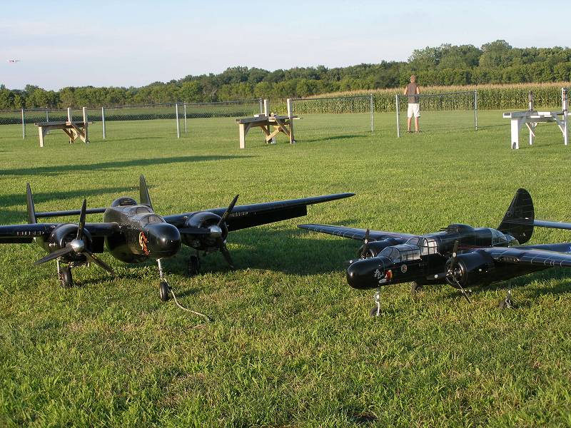

RE: Servo reversing
Don:
Why, yes it is...thanks for asking.
Ziroli P-61 Black Widow, overpowered by two G-62's
Sadly out for repairs since a rough landing last year. Here is a still photo of it and its little sister (VQ model)
www.youtube.com/watch?v=3tqliETnWOI for a short video of me landing it with an engine out. I'd like to brag, but it was mostly luck.
And, yes, it does have a couple of reversed servos: because of cramped compartments, the left aileron and the left outboard flap servos.
