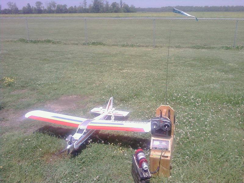

If you want to go over kill you can glass the wings together. when i built my trainer the wings seemed kinda lose, i didnt realy trust the seam, so Iadding a strip of fiberglass and some scarp momokote. you can see the sliver strip where i did this
