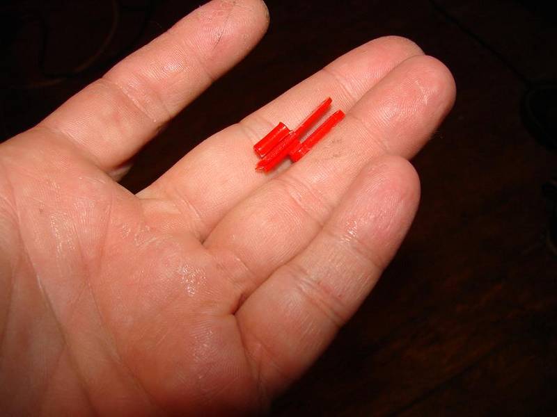

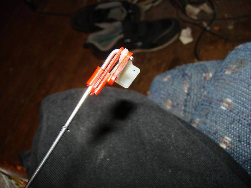

I will be using the Better swing keepers http://www.hobby-lobby.com/swing_kee...18442_prd1.htm
photo 1: The Better swing keeper
photo 2: One bend about quarter inch from end
photo 3: Line up the holes in the keeper with the hole in the horn
photo 4: Slide the bend in the wire into the holes of the keeper and horn
photo 5: Snap the wire into the slot of the keeper
photo 6: Ready to go
So easy.
