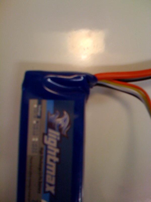

When I was unloading yesterday after I got home from the field, Idropped one of my lipo's on to the sidewalk. It didn't get punctured, but dented the side where leads come out a little bit. I placed the battery on a fire-safe surface and left it there for a good 4 hours. It didn't beginto bulge or smokeor anything. Do you thinkit's safe to charge andfly now or did Ijustmake $50mistake? I can post a pic later today if needed.

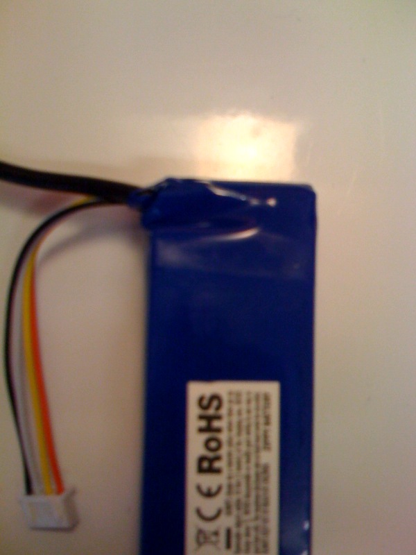

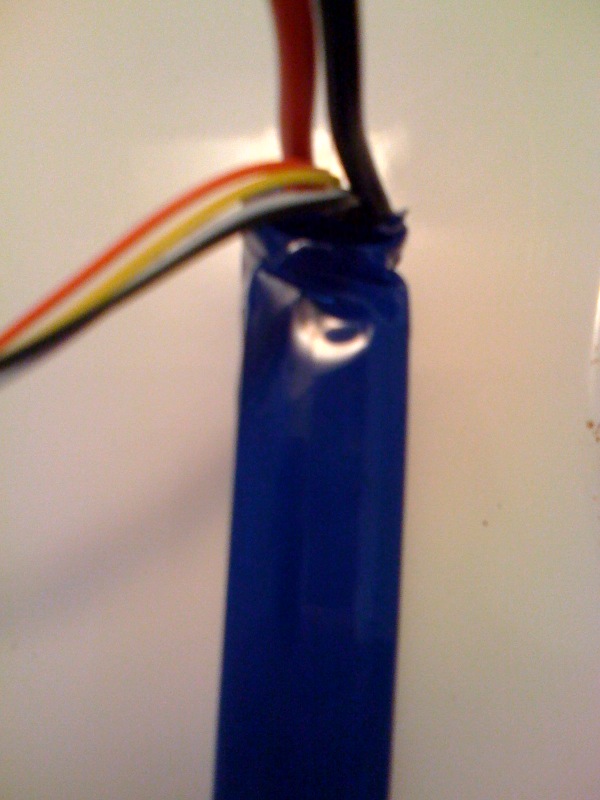

here are the photos. it's a 3s 2200 mah lipo.

Getting back the the original question, it's hard to tell from the photos, but it looks like you bent the end of the cell packaging where the solder tabs come out. It doesn't look like the main part of the cell was damaged. If the cell is damaged, it will usually start to leak or puff up. I'd do what MinnFlyer suggested, charge and discharge it  a couple of times while you watch it, and see if it gets warm or puffs.
