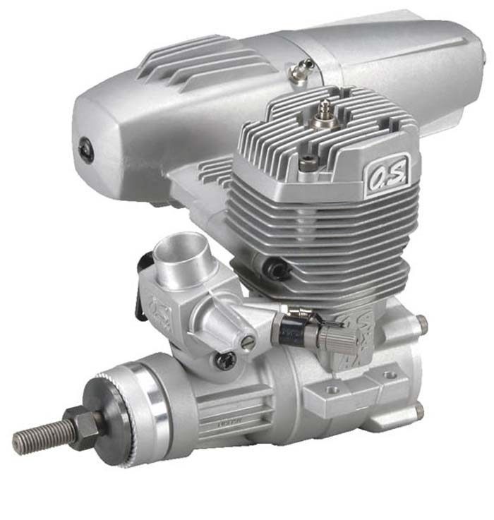

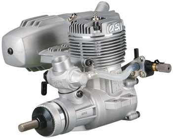

Default RE: adjusting needle
Many engines have a remote needle valve that is attached to the backplate of the engine. Others have the needle valve angled back from the prop (see photos below).

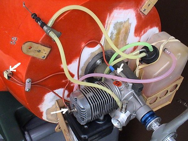

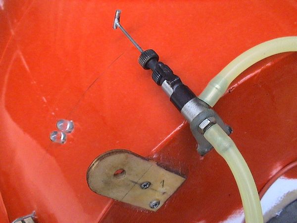

Hi!
You can mount the high speed needle nearly everywhere you like . Just cut it off /screw it off, from the carb and mount it on the fuselage.

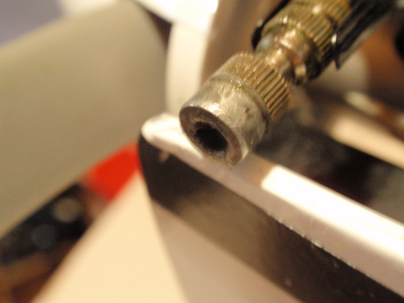

This was my solution to keeping my fingers out of the propeller. Icut the head off of a socket head screw and attached it the needle valve with JBweld. I can then use the correct size ball-end driver (I think it's 5/64) and hold it back at a pretty good angle away from the prop. Don't use a T-handle type driver, the extra leverage makes it very easy to over tighten the needle, which will ruin it.
