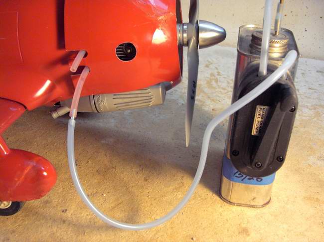

Well, John, you only missed the picture where you're turning the crank...

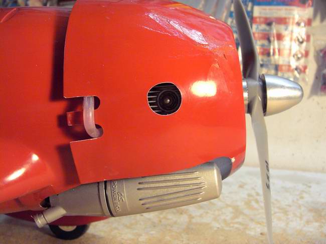

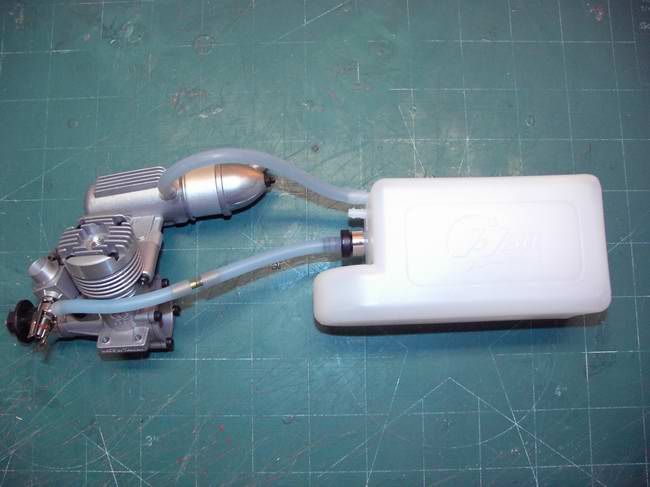

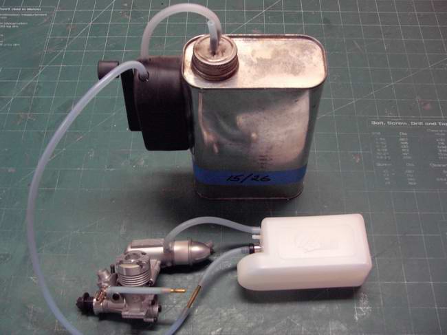

I figured John would show us his simple fueling system, it's the easy fool proof way to fuel any engines that are cowled. Great shots John. Istill use the three line but it's more a habit.
Igot into the habit of the catch can some years ago. A grass sod company used to allow flying off there sod fields but the cans were required so it didn't burn there grass. Inever did waste a lot of fuel from over flowing but with the can Ican be BSing with the guys and not have to be waqtching what I'm doing too closely. BS is a big part of flying!!!!
