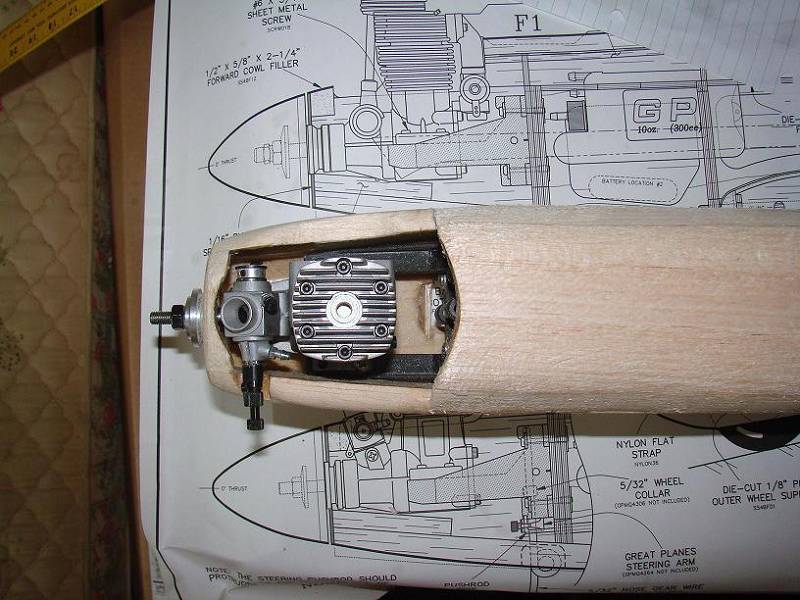

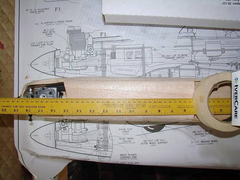

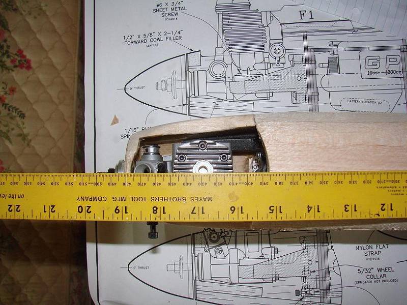

Is this too much thrust angle for a Super Sportster 40 MKII?
I had to put some washers on the right side to push the crankshaft and spinner to the center of the cowl ring.
Please don't tell me there is too much.

In the photos it looks like too much left thrust??? Ican't remember but Ithink the SS called for 2 degrees of right thrust. Ihave built a few but can't remember things like there thrust or CG anymore.

How do I fix it? If I remove the washers from the right side of the mount the shaft and spinner won't be centered.
Will I have to cut the cowl ring and redo? Will if fly with the thrust the way it is?

Last photo shows left thrust I defiantly don’t have that in my plane maybe you can add some washers.</p></span>
I have washers on the right side to push the shaft and spinner in the center of the cowl ring. If I take those washers out the thrust will be gone but the spinner and shaft won't be centered in the cowl ring.

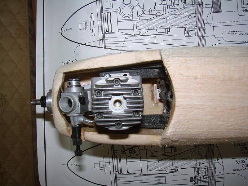

Here it is without the washers on the right side of the mount.
Real serious problem, don't know how it came out this off. Please someone come up with an easy fix. The cowl ring can not be removed and redone it is all too solid.

I guess the only fix would be to cut the cowl off at the red marks in the photo and add about 1/8" scrap to the left side at the blue mark. Then a whole bunch of scrap balsa around the cowl with alot of filler. Now all that will prob show through the covering.

I have a tiny sanding barrel that I use on a drill. The engine is perfect (thrustwise) right now without the washers, but the shaft/spinner needs to move about 1/8" to the right (see photo). Yes the motor mount can be ground but don't know if I can do it level, and that will add the thrust back in. The only way to fix it is as I stated above, and move the cowl.

It's difficult to tell the thrust line from the photos.  If anything, it appears that the engine is shifted slightly to the left side of the fuselage (This is what you want anyway to add right thrust).  If so, then a shim can be added to give the right thrust, but you will have to rework the fuselage to recenter the plywood ring to the spinner.
The best way to determine the thrust is to measure from a large prop tip to the tail from both sides when the prop is horizontal (make sure the prop is true by taking the first set of measurements, then turning the prop over half a turn.).
If they call out right thrust, you want to have it.  Otherwise the airplane will not track true when you pull into vertical.

zero percent thrust needed according to the plans. The engine is straight now so I can not add any thrust by putting something behind the mount. The cowl is what is off so like I said the only fix is to cut the cowl and add 1/8" to the left, pushing the cowl to the right. But I have to do this without making the fuselage front crooked.

Yeah, that's wrong, look at the spinner, in  the photo, it clearly says for bolth top and side view, "0 Thrust", go back and remount the engine at 0 and 0, the best way to do this is with a robart meter, it has a crank shaft adapter on one clamp end, just zero the wing and the stab and check the engine, remove the wing and with the fuse on it's side, level and zero out the rudder and now check the engine, it should be at zero. Good luck, but trying to ignore this will cause a very poor flying plane that reacts strange as you add and remove power while flying. I even use my meter when gluing stabs and wing saddles in place, it helps to verify that the plane is straight and true. It's only 25 bucks or so but you'll never stop using it.

There is no slide play in the mounts, the sides of the mounts are already touching the inside of the compartment. And if I could slide the mount over it would move the centermarks of the mounts so they would no longer be centered.
It is not the mount that is crooked, as I stated the engine is straight, it is the cowl ring that is off-center. And by shifting the cowl 1/8" to the right should center it. That is what I will try.
I really appreciate all the advice given here as I always do but I think I am confusing you all by making you think it is the mount/engine that is crooked.

The issue here is that you moved the engine (by putting shims under the mount) to fit the cowl. This was your mistake. The cowl is supposed to be built to fit the engine. By this I mean that the engine needs to be properly mounted on the firewall. Planebuilder quotes the plans as mounting the engine at 0 degrees on both axis. So, this mean the engine mount should be flat on the firewall, and the engine mounted on the mount with the shaft inline with the centerline (thrust line) of the fuselage.
You have two choices. One, mount it the best you can and live with the cowl being "off center" with the engine. Two, cut of the cowl and rebuild it properly. My advice would be to cut the cowl off and rebuild it. By doing this you can take the time to verify that they engine is properly mounted on the fuselage.

No, you DO NOT move the mount. If the nosewheel is set on the centerline of the plane, this is where it's supposed be. If you move the engine or mount to fit your off center cowl you are going to put some very bad thrust angles into the plane, which will cause all kinds of problems flying. Like I said, you need to cut the cowl off and rebuild it properly. Or live with the cowl being off center.

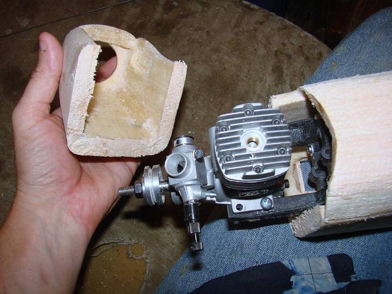

Cowl is cut off and repair has started. Check out my build thread to follow the repair. Thank you Ken, I knew I could count on you. Thank you everyone else for your advice.
