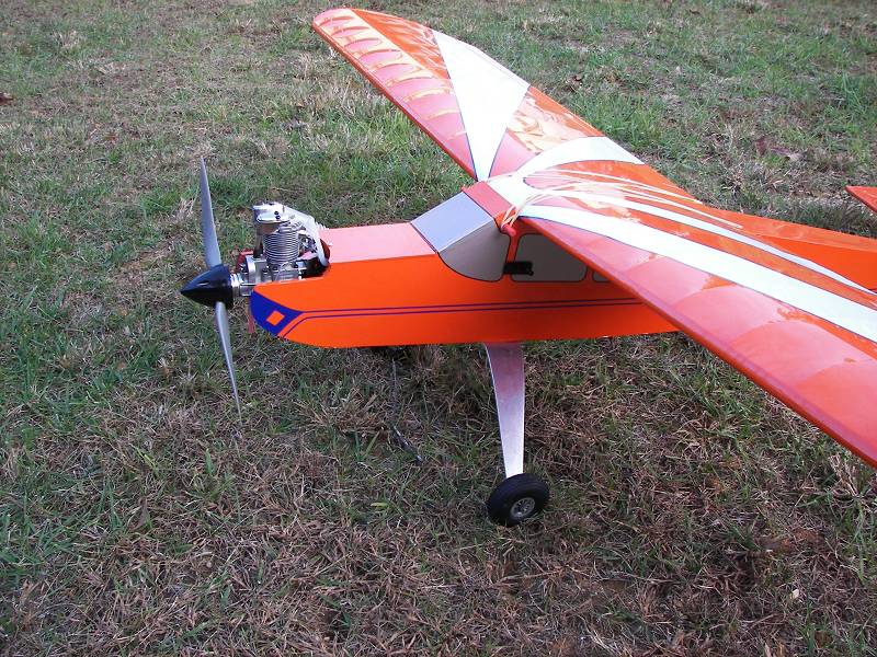

Old 07-01-2009 | 06:30 AM
Posts: 722
From: Wingina, VA
Default RE: What engine should i put in my Kadet?
I hear ya Bingo. I have also grown tired of 2 strokes. When my son and I built his Kadet we used a 56 Saito and it is one sweet flying plane.

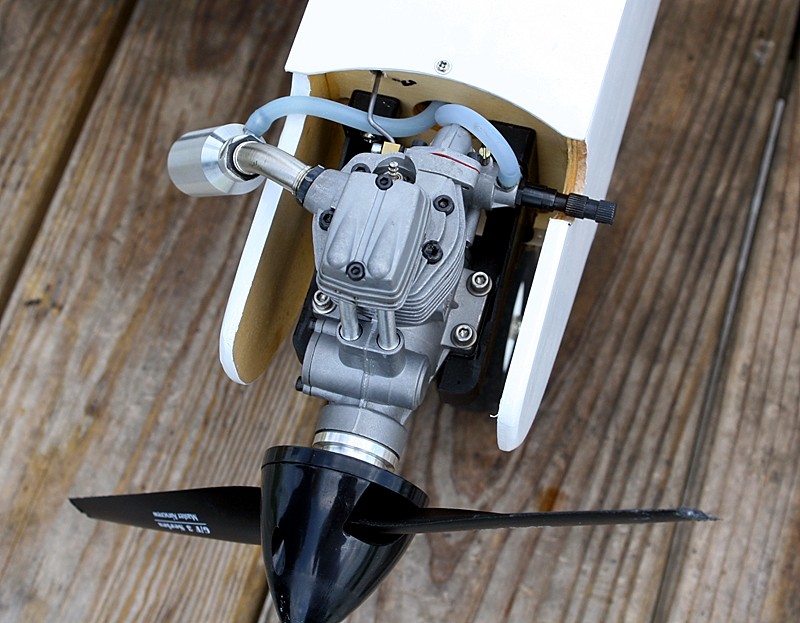

Bite the bullit and go with a four stroke. Youll be glad you did.

The Magnum .52 is a rock solid engine. I get 25 minutes of flight time on the standard tank so, in the long run, its cheaper. I actually had to add 1 1/4oz of weight to the rear but that was because of the landing gear I installed. I would highly recommend beafing up the landing gear. No more nicked props and mo more bouncy bouncy. lol
