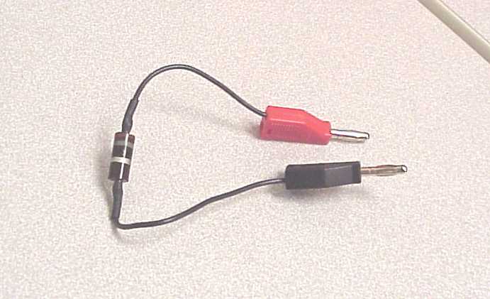

I suggest a digital multimeter - and not the kind made specifically for RC. Get a DMM from Radio Shack, Home Depot, Harbor Freight, or wherever for $10-$20. Add your own 20 ohm 2 watt load resistor from Radio Shack. This method will be no more expensive and much more useful and more accurate than an ESV. Search the old posts or check Red's site for more info. Use stackable banana plugs and you will only need to make two easy solder joints.

I already have a multimeter. Ok,,,,so I walk into RS and tell 'em I need a 10 ohm 2 watt load resistor. Then I solder it between the two leads and I'll be set?

Yes, that is all there is to it. Make it a 20 ohm 2 watt resistor. I had a mistake in my original post, which I have since corrected. This will give you about 250 ma on a 4.8 V pack, which is about what you want.
If your DMM has banana plug leads (most do) and you have a Rx charge cord with banana leads then it is handy to solder a set of stackable banana plugs (available from Radio Shack) on the resistor. They allow you to stack the charge jack on top. Just solder a plug on each lead of the resistor. Plug your charge jack on top of each of the resistor's plugs and plug the assembly into your DMM. If you ever need to check the battery pack voltage without the load then just unplug the resistor, etc.

Here are some photos of my loaded DMM. The DMM is a cheapo that I got on sale for $5 from Harbor Freight. It is a tiny thing measuring 1.5 x 4.5 inches but I checked it against a Fluke and it agrees to within 1/100 volt at 4.8 volts. It also measures resistance, ac voltage, ac and dc current, etc. Real handy to have around the house if you don't already have one.
The load is a 18 ohm 2 watt resistor (color code brown, gray, black). This is suitable for use with a 4.8 V receive pack and will draw about 270 mA. I soldered stackable banana plugs onto the resistor, which are available from Radio Shack for around $2. I used insulated wire and shrink tubing to connect the bare wires coming off the resistor to the banana plugs, but this is not necessary. You could just as well put the banana plugs directly onto the resistor's leads. The charge jack is from Radical RC and comes with the banana plugs attached. I think it costs around $3.
The resistor is not polarized - it doesn't matter which way you connect it.

nice pics, but I'm confused a bit.
In pic #1 the resistor is connected between (+) and (-). In pic #2 it looks as if it's connect b/w two (-)'s.

The picture doesn't show it as clearly as I had hoped. One resistor plug is connected to the "common" socket of the DMM and the other resistor plug is connected to the "V" socket of the DMM. The charge jack plugs in on top of the resistor plugs. One plug of the charge jack plugs in on top of the "common" resistor plug. the other plug of the charge jack plugs in on top the "V" resistor plug.
