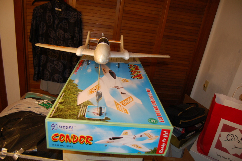

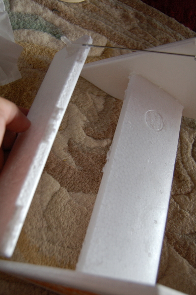

I have been thinking about getting a <font face="arial, helvetica" size="2">Shunda (same guys which make the wild hawk)</font> 2009 SD Model 3 Channel Condor EPP Foam Pusher Remote Controlled Bobcat Jet 100% Ready to Fly Super Durable, http://www.nitroplanes.com/new20sdmoco4.html for a while and I finnaly made up my mind to buy this plane and it turns out to be better then expected although the foam hinges need reinforcements (I used duct tape which worked nicely and easily) and it's not good to fly in 15+mph winds for a newbie. If there was no wind, I think it would have been much much easier to fly. It's too light and the motor is not strong enough to fight those winds/gusts which tossed it like the light weight foamie it is. It went together very nicely though and quickly. It took the impact of my mistake of flying in heavy winds very nicely as well (it broke the rear wheel off which went back on quickly with just a bit of gorilla glue as well as the elevator which went back on with some duct tape; the stock hinge is a bit of a joke. It's just a thin peice of foam which I knew would break off quickly). I'd recommend it as a plane for someone getting use to ailerons. I can't wait to fly it tomorrow.
Only one thing is off, the website said it is epp foam and the instructions/manual says it is epo foam. I'm not sure what the difference is to be honest but it seems like pretty strong stuff.
I'll post some pics tomorrow, it really is nicer then I though it would be.

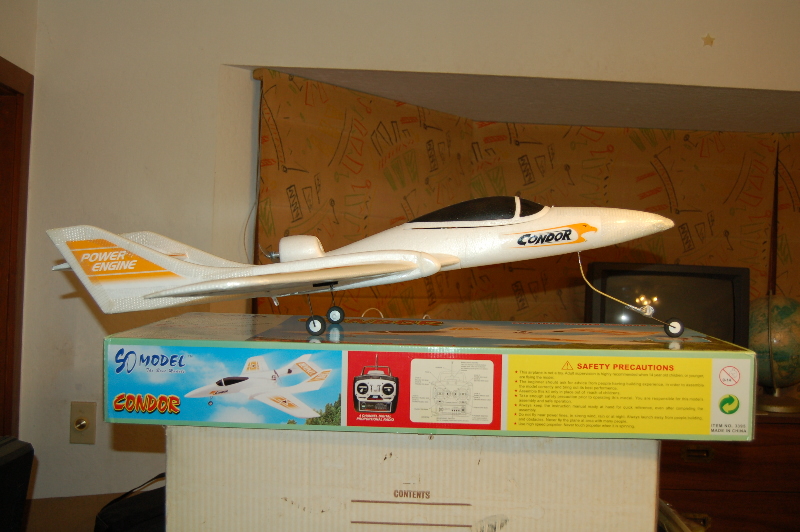

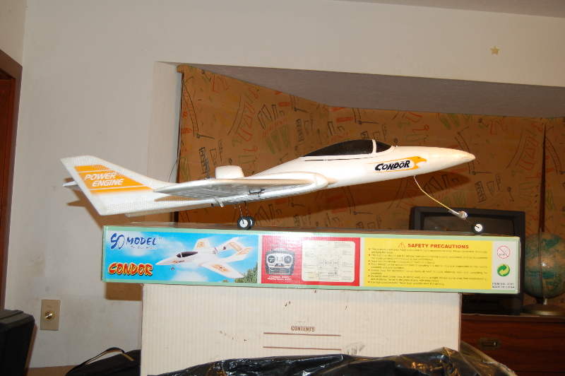

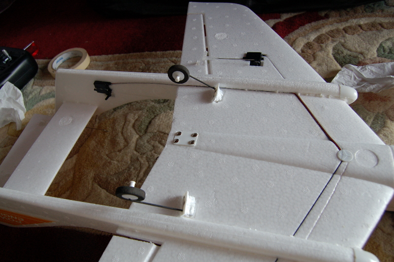

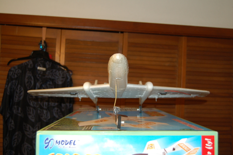

Here are some pics of the mod Idid to raise the front end, Ibasically took a coat hanger, cut it up, bent it up in to the correct shape, grinded it down so that it wouldfit in the stock slot forthe stock wheel,and duct taped the stock front wheel to it which is actually fairly stable. Yeah Iknow it looks a bit jacked but its just to test out to see if this even makes a difference in the angle of attack like opjose suggest me to change. with this setup, I can easily change the angle high enough so that the rear actually drags on the ground to being lower then stock (idk why I would wanna do that, perhaps for a lowrider look? haha
). In anycase, I'm having high hopes for this. One other thing Inoticed is that the motor and prop are more horizontal now as they actually use to be angled downward while taxing on flat ground on the stock setup which may have been contributing to why my plane was not taking off. Inever noticed this till opjose mentioned it in theprevious postand I found it to be true. I guess it helps give lift during flight but its not good when your trying to take off from the ground. Now the question is what angle should I set it at so that the wings have the most lift? wikipedia says most planes have it at 15degrees and anything above this with put it into a stall angle. Damn it, I wish my reciever worked so that I could go out and test this new mod out.

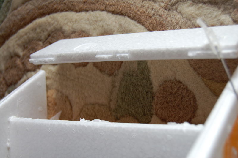

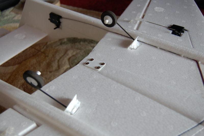

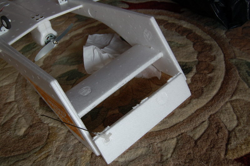

More pics of some damage the wheels and elevators took after my first crash and more pics of right after I assembled it out of the box. I fixed the rear wheels with gorilla glue and I used the reinforced packing tape for the elevator. Now both are stronger then stock I believe. I still can't believe they used just thinner foam to make the hindges for both the elevators as well as the ailerons. Seriously, could they not spend the little bit of money on some tape at least. The F-16 has real metal little hindges which are pretty cool.
15 degrees is excessive, and likely to cause problems.
You only want 2-4 degrees of positive AOA at most.
Bending the rear gear back is not a good idea, as it makes the plane more difficult to rotate.
You need to decrease the length of the rear gear a bit by cutting and bending.

Could you please explain what the "rear gear back" is? I'm assuming it is the rear landing gear.
ORIGINAL: opjose
You appeared to have angled the rear ( wing mounted ) landing gear backward, to change the angle of attack.
The problem with this is you are effectively changing the point where the plane rotates with respect to the C.G. as the nose tries to come up.
This is like putting a big weight on the nose just before takeoff, but removing it once in flight.
So it is not a good idea.
It is better to either shorten or bend the wires themselves a bit.
Typically we use a "V" bend to shorten piano wires when used in linkages, etc.
You may be able to do the same to the rear landing gear wire.
I'd use a wire bending tool to get this right and matched on both landing gear wires.
At worst you can go to a LHS and grab similiar piano wire and bend a new set of rear landing gear.

I left the stock rear wheels where they were and have not touched them at all. I assure you they are straight and perpendicular to the plane (should I move them closer to the Center of gravity?). Iwanted to make sure just incase I changed to another prop, there would be ground clearance as well plus it was much easier to do it this way. What I did was modify the front wheel so that it is attached to a coat hanger which is bent foward to get the front of the plane up (you might notice how long it is, it some stock the same lenght as the rear wheel wires). After I find the right angle/hight for it I will bend the front wire straight and cut it to size and then permantly attach it to the front landing gear. It may look like the rear wheels are bent but I assure you they are straight. They probally look like that because of the extreme angle the plane is at for photo purposes.
P.S. What is LHS. Ihave seen this acronym before but have yet to figure out what it stands for.
LHS- Local Hobby Store.
Your extension for the front wheel appears to be a bit extreme. As was said above you only want a few degrees of positive angle of attack. I don't think that front wheel will stay in place twith that long of a wire stretching it out in front of the plane. I t looks like it will want to swing around to the rear of the plane pretty quickly, or at best cause the plane to verr right or left during a takeoff roll. Any extension you add to the front wheel needs to be in line with the original position of the front wheel. You probably only need to add a 1/2" or so to the the front landing gear to get the plane to take off. This could be done by switching to a larger diameter wheel.

Ihave tried it out by running along side the plane for a bit (my receiver is currently dead/dying and my TX/RX range is about 3 feet right now, trying to get a new one from john but he doesnt seem to be online)and indeed it did veer just a bit to the side butI bent it to the left just a bit by hand and now it tracks straight. To be honest it's working out better then I had expected. The wire is pretty stiff to be honest and Iknow its pretty extreme, I just wanted a full range of motion (I'm a newbie and have never tested AOA before. When I had first made this setup, I had no idea what it was or how much I needed to be honest). Its just for testing purposes like I mentioned before and it will get cut down to size. I'd get bigger wheels but idk how (to find which ones would fit)or where to find then to be honest. My LHSsucks and is super expensive (I'm in Hawaii and have to order everything from the mainland, even with the shipping costs it's much cheaper then what is available here and at least I can buy what I want).
ORIGINAL: Flyin Beagle
