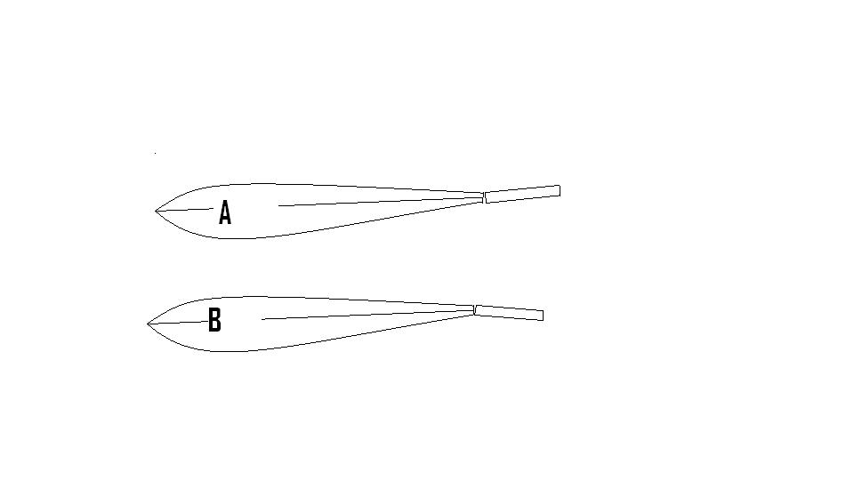

Which set up would make cause the nose to want to pitch up A or B?.... I am having a hard time setting the ailerons on a plane that has them running the whole length of the wing

a will cause the nose to pitch up. To set the ailorons properly you will need to centre the trims un screw the servo horn then have the two ends of the servo horns parallel to the wings then you adjust the length of the wires so you get both ailarons in the centre. Hope this helps

Do you have a symmetrical airfoil on the wing? or a flatbottom? Trimming the ailerons together in the same direction gives either a flap effect or a spoiler effect and whether or not those cause a pitch and how much depends on a number of things. Flap deflection sometimes causes a nose up pitch and sometimes a nose down pitch.
What is the model? and what do you actually wish to accomplish?
ORIGINAL: jimmyjames213
B will give you more lift, but the nose will drop,
A will kill your lift but your nose will raise up
Ok thats what i was looking for...i have a H9 Tango that im having trouble trimming the ailerons.....I have neglected this airplane for a while, and flew her again for the first time in a few months... and the ailerons were orientedtated like A and it scared the **** out of me..... i thought maybe i was tail heavy but i doubt it now
Actually what JimmyJames213 said is not correct!

The real answer is quite a bit more complex than stated in most comment above. It depends greatly on how the rest of the plane is set up. For an extreme example, look at the tail less designs that exist. The ailerons are set up as elevons and provide both roll and pitch couplings. If the CL is ahead of the CG, example A will pitch the nose up. I have had flaps on some planes that, when lowered, caused a pitch down attitude while such action generally causes a pitch up attitude requiring elevator correction to land with flaps.

It's not a given which way a plane will pitch when flaps (or ailerons being trimmed in the same direction) or spoilers are deflected, deflected either way.
For example, many models have been designed to turn in pitch EXTREMELY fast. They were designed to turn inside very fast and to turn outsides just as fast. With those airplanes when A happened the airplane nose pitched even faster DOWN, and when B happened the nose pitched even faster UP. Why? Because the wing was increasing lift in the direction of the turn, either way and that lift helped the elevator pitch the plane.
There are models that pitch nose down when their flaps are deflected. There are others that pitch nose up when their flaps are deflected. It depends on the airfoil, the balance of the particular plane, and the location and size of the tail. And the airflow aft of the wing. And maybe one or two other things.
There is more to it than a sound bite.

Ok ill add some weight up from to be on the safe side and try to neutralize ailerons as best as i can... I just want the Tango to fly straight and be easy to trim, and most importantly enjoy it
Maybe it's just me and I'm missing something but unless both ailerons are moving up and/or down at the same time, you shouldn't have any nose up pitch issue. If you move the stick left, the left aileron should go up and the right should go down and you turn left. Generally the plane will pitch down some. The reverse is true if you move the stick right.
So, what's going on to cause you to think that the ailerons are giving you pitch problems?

Although I hate to say it but this sounds more like an airplane that is simply
being flown with the CG to far aft in the first place. If thats the case reflexing the ailerons either direction is not going to help.

OK, I have glanced over down through post #14. First your depictions do NOT provide any true information.
While one can find many variations as most model airplane depict the longitudinal axis as a point to measure incidence. In the real world that is not true. The chord line of the horizontal stabilizer is the line from which all aerodynamic incidence angles apply.
Example: A depicted longitudinal axis shows 2° downthrust, 2° positive wing incidence and a 1° negative incidence for the stabilizer. Aerodynamically the machine has 1° downthrust, 3° positive wing and zero for the stab.
Now you want to adjust your ailerons for certain wing incidence changes. OK, so what kind of wing do you have?
Most flat bottom wings have a rounded leading Edge. Since chord line is between the farthest forward point and the trailing edge, then a flat bottom wing already has some positive incidence relative to a flat stab. parallel to the bottom of the wing.
Any droop of the ailerons provides more positive incidence, more lift for a given airspeed, and probably a bit more touchy on the controls, especially elevator. Roll those ailerons up a few degrees and the machine now generally flies smoother. I cut all full span ailerons off some 2-4" from the outboard tips and glue those tips back to the main wings with a slight twist-up. T.O. and landings are much nicer and most of the dreaded "tip stall" is eliminated but never totally eliminated.
Symmetrical wings must fly at some positive angle-of-attack (AOA) normally not perceptual to the eye, depending on wing area, weight, and airspeed. A slight roll down of the full span ailerons will make the model less touchy, but inverted flight will require considerable nose-up (down elevator) pressure and the model will be seen as such. That is why most aerobatic pilots use neutral control surface settings and use an aft CG which applies the down force to load the wing to some AOA to maintain adequate lift, regardless of whether upright or inverted or on an up-line or down-line. (AOA is the angle between a chord-line and the oncoming airflow. AOA has nothing to do with INCIDENCE angles)
Roll up the ailerons on a sym. wing and it flies with the nose up dragging itseld to adequate positive AOA along with a draggy fuse. and stab. Pressure a slight bit of down elevator and it litterally wants to fall out of the sky.
I have assisted a number of RCers with a squirrely scale model on TO/Landings/ and even in-flight maneuvers by showing them how to roll up the ailerons several degrees, 1/16" or more, and therefore tame the tiger. It's simply "washout" which all machines like.
Hopefully the above explanation/s will provide adequate information for you to adjust your ailerons to what you wish. The only definite is that there is no definite. However the less differential incidence between stab and wing chordlines, the easier the machine is to fly. That will all change when you start flying Free Flight.

I think John Buckner might be right about the CG being too far back..
Well for a very proficient flier with a strong power plant, and wanting 3D stuff, that can work. OTOH for a sport flier with a less than a barn-burning engine, it is a crash waiting to happen.
Your wing has a slight taper. Your mean aerodynamic chord (MAC) is "close" to the mid point of the wing panels in SPAN. Not exactly but that suffices close enough for toy airplanes with such a wing.
If you go to that point and measure back 25 to 30% of that chord, and balance at that point your airplane will not be tail heavy.
Now are your tail servos at the rear of the model? If so, take those servos, place them in the fuselage and use pushrods, stiff and braced ones. Then you are moving 3 oz. of weight forward to close to the CG. That is about a 3 to one advantage or the same as adding 9 oz. to the nose, except you remain 9 oz. lighter and get the same effect, CG wise.
Since I don't know the taper and using their figures for span and wing aera:
48.5" span with 747 sq. " aera = chord of 15.4" (for the perfect rectangle) however on a straight taper that should be close to the center of the panels span wise.
25% of 15.4 = 3.85 30% of 15.4 = 4.62
Any balance point between 3& 3/4" and 4& a half " will give you a nice flying airplane.

MJ Yes your airplane is being flown with the CG too far aft for you. The reflexing of the ailerons up or down does have effects that can improve various segments of flight but usually at a cost of some other end of the flight envelope.

not sure where the cg is on the model i threw the manual away and didnt bother CGing it, since i had the correct size 2 stroke motor, the servos in the stock locations and battery pack as far forward as possible... I will add a couple of ounces if i choose to fly it this weekend.
Horrace and John thank you for taking the time to explain how to balance a model[sm=thumbs_up.gif][sm=thumbup.gif]
