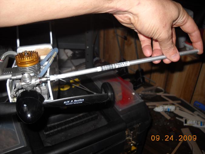

Old 09-24-2009 | 09:11 PM
Joined: Aug 2007
Posts: 1,610
From: Pittsfield, MA
Default RE: Question of ethics . . . needle valve tool
The needle valve on the left of the engine, whichever that is low or high speed don't know terms.
I simply enlarged the opening at the end of a scrap tube I had laying around to safely reach in to adjust the valve. I have always seen this adjusted with the engine running, and I am too paranoid of the harm that could result so I feel safer having something to reach in to adjust.
ID:	1281679   Click image for larger version
ID:	1281680   Click image for larger version

Old 09-24-2009 | 09:35 PM
RCKen's Avatar
RCU Forum Manager/Admin
Posts: 28,246
Received 31 Likes on 27 Posts
From: Lawton, OK
Personally I don't like getting anything metal or any other tools that close to a spinning prop. It's too easy for the end of that tool to wander into the back of the prop and then it's going to be propelled right into your hand. IMHO it's a lot easier to loose control of the end of that long rod than it is to let your hand wander into the prop. It's just my personal opinion from being around these engines a lot but I think you have made the situation more dangerous with your setup than if you simply adjust the needle valve with your finger. You're free to do what you want, but I personally wouldn't use a setup such as that as I don't think it's safe.
Needle valves such as this can be safely adjusted with your hand as long as you adopt a few safety procedures. The biggest of this is to NEVER let your hand or fingers to get any further forward than the needle valve itself. When I make these adjustements I come in from behind the engine with my hand even with the fuselage of the plane. Then I use my thumb and forefinger to turn the needle valve. My hand or finger never get anywhere near the prop this way.
Ken

Old 09-24-2009 | 09:57 PM
N429EM's Avatar
Joined: Jul 2006
Posts: 241
From: Omaha, NE
The procedure RCKen has described is right on.
The second picture you have posted is an accident waiting to happen.
The only time you should, ever, reach over a spinning prop, is to remove the glow starter. And, that's only if your plane is firmly restrained.
BTW, you are adjusting the High Speed Needle (HSN).
With all of the JBweld on the other side of the carburetor is it possible for you to adjust the Low Speed Needle (LSN)?
EJ

Old 09-24-2009 | 10:28 PM
Joined: Aug 2007
Posts: 1,610
ORIGINAL: N429EM
EJ
You and RCKen make a great point . . . SAFETY FIRST . . . and I will not use a tool for the adjustment.
I would never reach over a spinning prop in the manner shown, that was only for the purpose of the photo to show what I thought was a good plan of action.
The carburator/throttle arm broke off and the only thing that would hold is JBweld. And yes, the LSN needle screw moves freely, was very careful in applying the JBweld.

Old 09-24-2009 | 10:54 PM
RCKen's Avatar
Posts: 28,246
From: Lawton, OK
ORIGINAL: shd3920
http://www.rcuniverse.com/forum/m_90...tm.htm#9070204
If this is the problem you were dealing you didn't need any JB weld. A center punch should have been used to "peen" the ring back onto the throttle arm. The arm should have been replaced and then the punch use in the old punch areas to spread the metal out to hold throttle arm on. While not the best way to attach a throttle arm it is still a good way of doing, and allows for easily taking off the throttle arm if the carb needs to be disassembled for whatever reason. Unfortunately now your "fix" is permenant and you will never be able to get the carb apart if you need to do anything to it.
I'm not trying to be harsh here, but rather just trying to point out there the proper way it should have been done. Unfortunately it won't help you on this application, but the knowledge can help you for the next time you have to deal with something like this.
