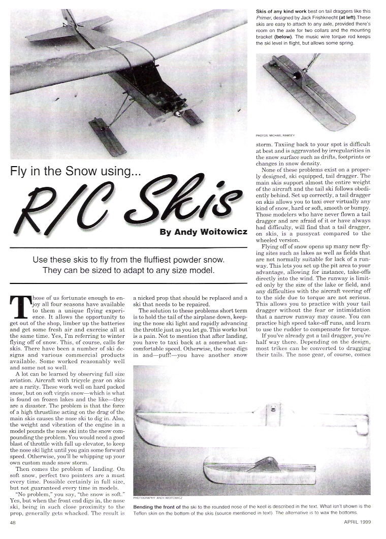

Here,
http://video.google.com/videoplay?do...ter+minisport#
you can see my ski design in action. This was a day, just a few degrees below freezing, the snow was dry and powdery. No wind and lots of sun makes it a very enjoyable experience. Note that the tail has a small ski as well, this makes it all work just gang busters.

Thanks for that article.
Everyone making skis should read this. Note where they place the pivot and then go look at most commercially available skis. You can use skis in a foot of powder with no problem if they are designed properly.

Hi Tom,
You're welcome and thanks for the thumbs up. We DO get snow, and this ski design, if you can get the cementable teflon, will work in most snow conditions. Placement of the axle is also quite important, as you say, and most commercial designs overlook this. If you can't get the Teflon, a smooth finish with glider wax works well too. This is used on waxless, cross country skis, the ones with a unidirectional pattern on the bottom. We had one local apply Monokote to the bottoms and that worked well for the season. For the next season, he'd just redo the bottoms and good to go again. Indoor flying is great but it's good to get out in the fresh air during a long, cold, dark winter.
