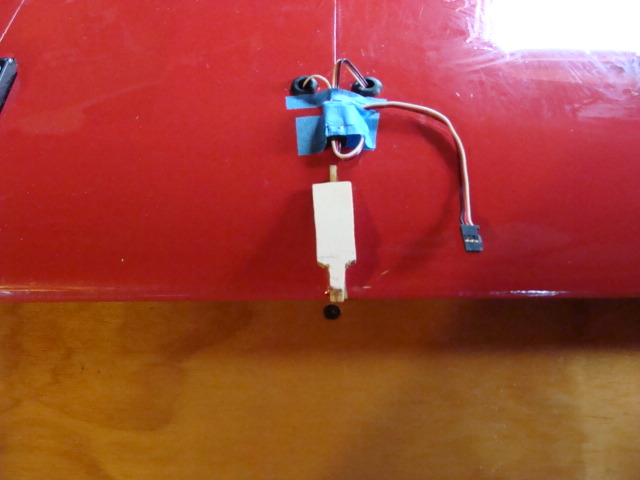

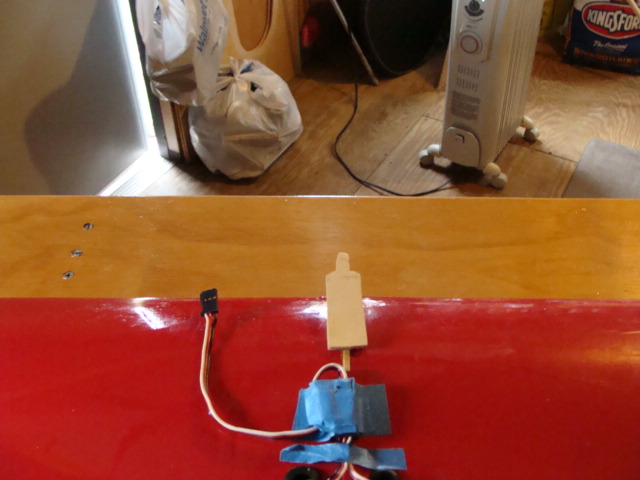

Hi folks,
Just received my GP Stick 60 kit and was planning on working on it this week-end, but I noticed one of the wing holding tabs is broken. To send the plane back and get another one is 7-10 days, and I am debating whether I should just fix it. Normally I would fix a small thing like this and wouldn't even ask the question, but since the tab holds the wings in place I thought it would be a good idea to ask you experts. I was planning on putting epoxy in between the broken pieces and clamp it closed. I could also possibly fiberglass the area once the two wing halves are joined together.
The plywood looks rather light, so even if I get a new one I'd probably re-inforce it.
Your thoughts? Should I send this back and wait two weeks or fix it?

I had read that the 2 tabs where a weak part of the
Stick.
Here is what I did to reinforce the area. My 40 size
Stick is in it's second season and is a blast to fly.
Hope the pics help you ? To answer your question,
I would just fix it.
Bob

Yep, already started, just needed a nod from someone...
You are right, the plywood is really light (is this what you call liteply?) The landing gear and the wing holding areas also seems somewhat light, so I'll beef that up a little as well. Is it necessary to glass over the area where the two wings join (like you do with kits)?

I don't recall glassing the middle of the wing, just Epoxy. I lrt
it cure for a couple of days. I too reinforced the area where I
mounted my tail dragger gear.

ppkk, Whey you are ready to join the wing halves together, apply the epoxy to wing roots as needed and, like you said; in between the tab's broken pieces. Use Wax paper on the completed tab assembly and clamp together. 30 Minute/slow cure epoxy is best for wing half joining. Allow a day to cure then file any excess epoxy away for a properly shaped mounting tab.
Glass tape the center section to help prevent "wing folding".

ppkk, Unless you plan to enter the model in a contest where appearance will earn you points...reinforce the center section!
Remove the monokote back far enough to expose about 1/4" of bare wood outside the tape you choose. Mask off farther out where you don't want the epoxy to run. Bottom and top tape get done in one process, but it takes two steps...Do the bottom strip first, wrap up & over an inch or two LE and TEdge, cutting a bit to surround the mounting tab at LE and forget for now about the wing mount bolt holes at TE. (They can be cleaned out after)
30 minute epoxy allows plenty of time to do this job.
