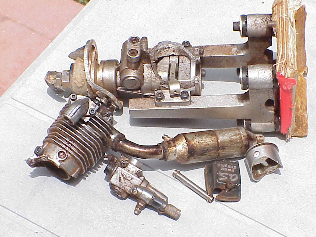

Are 4 strokes more likely to grenade like that than 2 strokes? It seems like I've seen more fragged 4 strokes than 2 strokes.
RE: Silly Engine! Bolts should be tight!
The damage in that photo is from a crash. Look how relatively weak the design is compared with a much more compact 2 stroke.
ARP, a leader in the bolt business has a slogan, "tightness is what keeps bolts tight".
The acquired feel for how tight this is is easier understood if you can visualize tightening the bolt to the point of stretch, but not to the point beyond the bolt's elastic limit to return to the original length when loosened.
I hate the new editor. Some how, this pic I posted got moved to this thread from a PM that I was attaching it to. One bump of the wrong key and things go to hell.
For those interested, I trashed the O.S 52 for stroke by getting disorentated and upside down and pulling full up and full throttle. First contact wht the ground was the rocker cover. the photo shows the rest. It has nothing to do with this thread. Sorrry for the confusion.
Don
Don
ORIGINAL: brett65
Having flown C/L combat, ratrace and Goodyear......... I've seen a lot of 2strokes go.
Having flown mostly weekend R/C for about as long, I can't remember any 4stroke in ruin that wasn't just a meltdown from the owner setting the sucker by ear. Certainly never saw a crank go and don't expect to.
But then, I've only seen a few R/C 2cycles ruined. One guy did most of them in. He likes to go fast. (He's the only guy I've seen trash an OS, btw.)

The crank in my photo above was about the only thing I salvaged from that engine. Other than dirty and a dinged threaded end, it came out fine. I can't beleive how tough they are.
