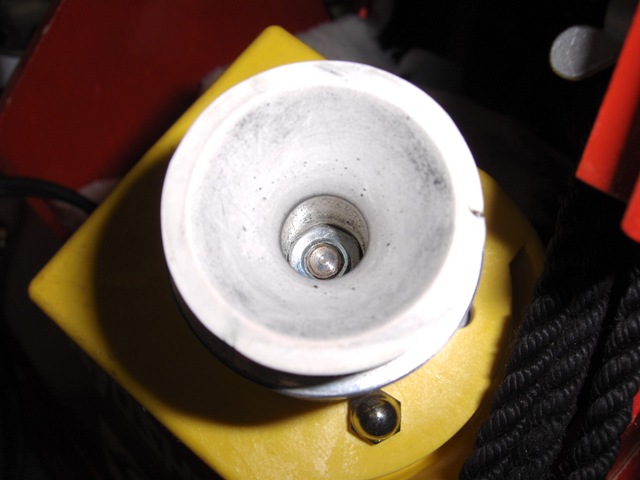

Well, I put a ring on my spinner today. I put on a brand new Great planes Nylon cone, aluminum back on a Saito 91 I just rebuilt. The starte cup is/was a fairly new whie one. The engine is higher off the bench than I'm used to and one of my budies informed me that I was about 25degree down on the starter. The engine was giving me fits, glow plug, way wrong starting setting. Well, I about melted the nose off the spinner. After one cranking, when I pulled the starer back, there was a string of plastic cobwebs between the spinner and starter cone. It's still one piece, but the nose is really rough. Ifinally got it running and it is running well.

This is what mine looked like today after one start. Sulivann Super hi torque on 24V and an argumentive engine.

Yup, the starter cone is not gripping the spinner properly and is spinning, wearing the plastic.
Use a Silicon starter cone, keep it clean, get one that PROPERLY fits your spinner, and apply pressure and you'll be fine.
I see a lot of people resorting to "bumping" the starter cone into the spinner, this also causes undue wear.
