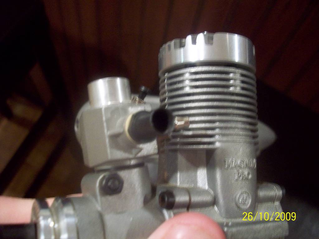

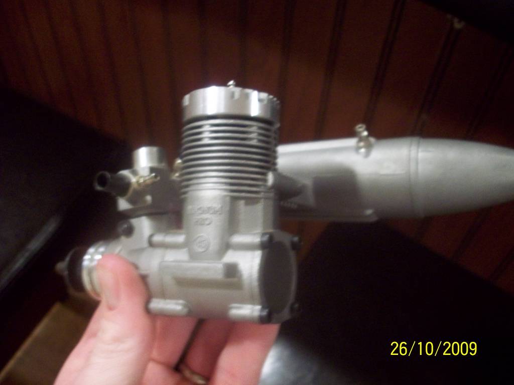

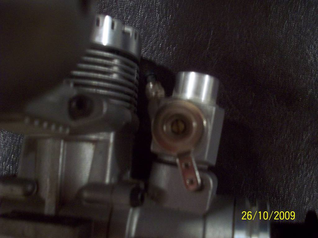

My dad gave me this engine as is never used. I am assuming this is missing an adjustment needle. I dont know if there is supposed to be one on the side of the carb where that black hollow piece is or just like a remote mount needle on the back, or both. Its a magnum pro .45. Does anybody know where Ican get the parts for this or what was supposed to come with it?

You are missing two parts. the high speed needle valve and the detent spring. The Magnum needle valves are mostly common asross the line, so If you have another Magnum engine, that valve will most likely work. You can get the replacements at Hobby People's parts http://www.hobbypeople.net/gallery/282310.asp
Don
PS
Looking back, this may not be the right engine. Call their parts people, they are very good at helping and if worse comes to worse, you can probably put in a current model carb. They will be able to tell you though.

Campgems has given you good info and a link to call about getting a new needlevalve and the detent spring (good eye Camp).
That model Magnum engine has been out of production for some time. The reason the needle valve and its detent spring is probably missing is frequently they are packaged separately with
new engines and it may be that package was lost or misplaced since the engine was never run.
That is the original type carb and it is a front needle type not a remote needle valve (thats a plus in my book).
