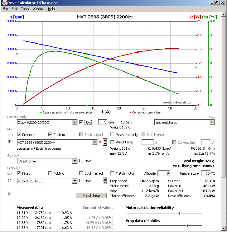

Anyway, here are the two charts that I produced with two of the several props that you had. The two props are kind of at the opposite ends of their respective ranges, so one is speed and the other is thrust. Take a look...
As you can see in the first picture, the prop is a 4.74x4.75 and it will pull about 13.7 Amps at 10.69 volts pulling in 146Watts. It will make about 328 g thrust, and do about 112 km/h which is clicking along pretty well (actually very good for a flying wing or funjet).
The next chart shows the 6x4 prop pulling in about 16.3A at 10.61v and 173 Watts. It will make about 640g and do about 85k/h which is significantly slower and might not be very fun. Both props are running about 70-74% efficient which isn't great for an inrunner, but considering peak eff for this one is about 78, you aren't too bad off.
At this point I would say try all props and see what you like. Make sure you have an ESC that can handle 16A * 120% or about 20A and you should have some great fun.

Wow!! thanks for your help! I'm gonna use the 2200kv first then. I bought it with the funjet, the stock motor is 1800kv. I also got a 25-30A ESC so this should be a good setup. Your results confirmed that. I'll try out this drive calc.
With the second setup with 6x4 prop, it has more thrust.... shouldn't it mean it'll be faster than the 4.75x4.75? Somehow it's not.

No problem at all. Check out the tool and let me know if you have questions. It is pretty powerful, especially if you decide to invest in a Datalogger, or even a wattmeter (every electric pilot's best friend). The datalogger will show you RPM, Current, Voltage and other things like temps and stuff. I have one and have built a few motor databases and it is very useful.
Remember that the 4.75x4.75 has a pitch that is about 19% higher than the 6x4, and because the diameter is 1.25 inch smaller, it can use it's power into providing thrust at speed, rather than thrust at stall. This allows the prop to propel the plane at a rate actually higher than 19% greater than the 6x4 prop. It's kind enigmatic if you think about it.
Peak efficiency is more of a guesstimate to see if we are applying the motor properly. If the motor's peak was say 90%, but we propped it for 60%, then we are probably misapplying the motor. If it is 78% and we prop for 73%, we are doing pretty well with the given motor. I think you're on to it. Keep playing around with things. I would always recommend a wattmeter or a datalogger so you can see what your actual setup is drawing to keep your ESC, motor, and battery happy.

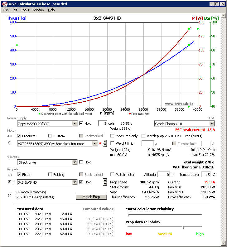

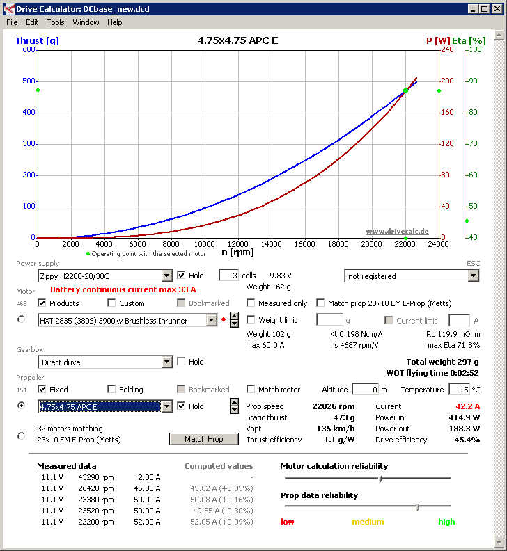

I was playing around with Drive Calculator. And used a 3900kv motor instead of the 2200kv. Now my speed shot up wot 139km/h. But efficiency was 45%. What does this actually do to the plane? I go faster but what am I losing? So I'm losing 30% eff to what? Also when I put in a smaller prop, 3x3, it goes faster! So if I wanna use a faster motor, I have to use a smaller prop? It's tough to figure out how a prop and motor affect each other. I still don't get it.
What is happening is you are loosing that energy you put in to heat. The 3900 kv motor is used for a couple of things:1. A heli motor where it is geared way down before going to the rotor. 2. A motor for use in a ducted fan, where the impeller diameter is very small (maybe 55mm ~ 2 inches) or 3. a plane like you have (a funjet) but using a 2S battery instead of a 3S. The higher kv motor in the same sized motor will generally handle more current, because there are fewer turns of wire, so the wire in the same stator can be of larger guage and handle the increased current.
You can think of the number of turns kind of like the gear ratio in a transmission. The more turns, the higher the gear ratio, and the lower the output speed of the motor given the same voltage. Note: this doesn't perfectly equate across product lines, but for the same design motor with the same number of poles, it is generally true.
Confused yet? Finding that "perfect" motor is impossible, but I think with a little tinkering you can find one that will work well for you.
Curtis
P.S. On that first chart you posted, did you see what happened to the current? Try putting your 3900 motor back in there with the 4.75x4.75, but change the number of cells in your battery to 2 (like in bullet #3 above) and see what you get.
