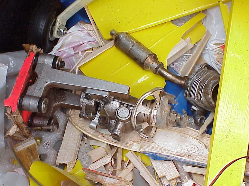

Guys, I've crashed more planes than I like to admit. i"ve yet to break a motor mount lug because I always drill and tap, using a drill press to make sure it is straight and square, and on target. Imounted a Mag 91 on the stock plastic mounts for a 4*60 and used Stainless steel #8 socket head cap scrws. Full tthrottle lawn dart into the ground, well dried adobe clay. The motor mount broke, the stainless steel cap screws bent, but the engine wasn't damaged. I've seen lugs broken off when using thru drilled holes, stove bolts, a size or two to small because the holes were drilled off pattern, well you name it. The motor mount is probably the most stressed part of your plane.Not mounting your engine firmly, and accuratly is asking for trouble.
This photo shows how a properly mounted engine can survive a crash, well at least the lugs didn't break and the mount is usable in another plane. The rocker cover was first contact with the ground. It used to be an O.S 52 four stroke.

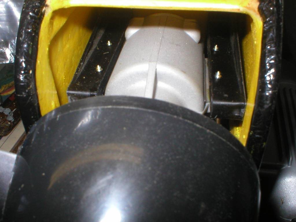

Campgems...That's what I call a real "Yard Sale"!
Here is a photo of sheetmetal screws holding a .61 in a Tiger 60. The screw length should have been such that three threads are showing after final assembly and tightening. Note the clearance between the engine mount and crankcase. No problems to date.
Drilling and tapping works well also.
"Through Bolting" is the most secure method.
I use a small flat washer between the head of any chosen fastener, and the engine mounting lug.
No matter which type of fastener you choose, I recommend after a few flights, to check the fasteners for tightness, even though this might require removal of the spinner/prop/muffler/cowl, etc.
Furthermore, every now and then before flying (and before starting the engine) I think it's good practice to grab hold of the engine and give it a test for mounting tightness/security. You might get surprised one day[8D]
