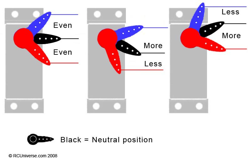

CGR's post is most informative, but...
Only SOME brands of servos have the servo arms that will angle slightly when rotated to the next arm (if you use JR, you're out of luck)
And you don't ALWAYS want the arm to be at 90 degrees.
When the arm starts at 90 degrees from the pushrod, you will get the most amount of travel, but sometimes, you're stuck between a rock and a hard place, IE, when one hole on the servo doesn't give enough throw and the next one out gives you too much.
A blank arm like AA5BY suggested is a possibility, but it is easier to use the arm you have and rotate it off the 90 degree mark - which will give you less throw.

Mike, you mention, but the drawings don't point out that the 90 degrees is to the push rod, not necessarly the servo case. I bought a used plane and the guy had the pushrod coming across the fuselage at a 45 degrees to the servo case. He set up the arm for 90 to the case and of course, things didn't work as you would have liked.
Ithink the imporant point of this thread is thay you really have to mechanicaly set things up correctly, Even with a computer radio. The throttle is the hardest servo to set up in the whole plane in my view.
Don

ORIGINAL: Campgems
I realized that as I typed it, and I only typed it because if you've been in this hobby long enough, you've run across one of those cases where the throttle cable is NOT coming in at a 90 degree angle.
The illustrations assume that the pushrod IS coming at a 90 degree angle.

Mike, Don, perhaps my emphasis was to point out the "square" position of the servo arm to the servo. This is, of course, assuming that the servo is square in the tray and square to the fuselage. That's the way I try to mount them.
