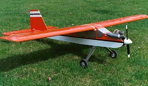

Those newbies that are wanting to build a kit instead of an ARF, here is a great combo if you are trying to cut costs on that first engine and kit. Put an OS .40 LA in the Sig LT-25 trainer.
I have 3 Saito powered low-wing planes ...but.. I LOVE flying this little trainer. You will notice.... it is a tail dragger as it comes in the kit. This is NOT a small .25 size plane. It has a 63" wing span and mine weighs out at 4.5 lbs dry. I built mine to be more aerobatic with very little dihedral. I used a control rod instead of their pull-pull system for the steerable tailwheel. I was shocked when it first flew. The old worn LA, with a 10-6 prop, will ALMOST pull unlimited vertical because the plane is so light. The kit is an easy build with ALL laser cut parts. The only thing I didn't like is the formers are also basla. I did a little bracing and hardened some formers with thin CA. The fuse doublers are also balsa as there is very little ply in this kit. I saw NO problems using the balsa fuse doublers as in plans. Dont be affraid to put some extra gussets or braces in the wing tips or any other places you feel should have it. (I do NOT build light... and this thing still came out at 4.5 lbs!!) Just food for thought while scanning the "wish books"!!
PS. As with a lot of planes.... add some triangle stock on both sides of the rudder to support it's contact with the stabilizer!!!

I have to agree that the 25 is a great plane. I built per plans with the only difference being that I also used very little dihedral when I glued the wings together based on another pilots suggestion. This makes the plane fly very well even in windy conditions. Later I added axles to replace the 6-32 screws which were always coming apart causing the tires to rub. I use an SX32 engine with a 10-6 prop and I can take off in about 10 feet! I taught my son to fly invertered circles around the field and the plane will do knife edge. Get one and you won't be sory!

They fly great with a 25LA as well.
With a 25 they are plenty strong without any extra bracing. If I build another one the only strengthening I will do is to include a small stick on the top of the wingtop former sheet. Id you catch a wingtip that spot is kinda light.
I've had both the LT-25 and the LT-40 (actually still do). I like the 25 better. It's a little more responsive but you can slow it down and it will be a lot easier for beginners than the great majority of the popular trainers.
