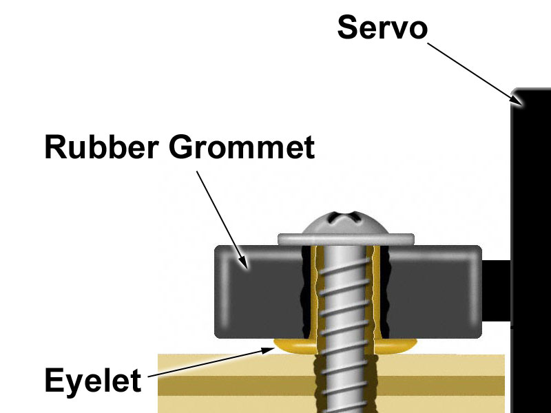

I have a hi torque rudder [link=http://www3.towerhobbies.com/cgi-bin/wti0001p?&I=LXUZ80]servo[/link] I just installed in a used 72" QQ Yak I purchased. In all the time I've been perusing the rcu forums I've never seen detailed information on hi end servo mounting.
The servo came with quality rubber bumper pads for each hole which I installed. It also came with little brass inlets for each hole. I installed these with the lip up. I used my own heavy duty cap head self tapping servo screws and a long metal servo double arm with Hitec insert. Questions:
1.) How tight should the servo screws be tightened down, enough so the rubber pads are compressed about half way?
2.) What's the purpose of the brass inlets?
3. Are there any tips on installing digital hi torque servos that anyone can offer in order to do a quality installation that will last and not come loose nor put unnecessary strain on the servo itself? Pictures would be appreciated.

Many people make mistakes when mounting servos that can lead to servo damage, premature servo failure, or other problems. When installing the servos the brass eyelets install from the bottom of the rubber grommet, and then the screw is tightened to where it just touches the top of the rubber grommet. The purpose of the rubber grommet is to isolate the servo from the vibration in the airframe during flight. If the screw is over tightened to the point that the rubber grommet is compressed any the isolation characteristics of the grommet are gone and vibrations will travel directly into the servo, which can damage it.
See attached diagram
Ken</p>

Here is the mounting procedure from the Futaba website. Other brands will be pretty much the same.
Proper Servo Mounting:
The proper way to mount a servo is as follows:
1 Insert a rubber grommet into each of the four servo holes.
2 Insert a metal eyelet from the bottom side of the rubber grommet. This way the wide portion of the eyelet will be in contact with the servo tray when mounted.
3 Test fit the servo in the tray, and enlarge the openings so the servo will not touch the tray. The rubber grommets will isolate the servo from the hard vibration of the airplane's structure.
4 Position the servo, then mark the location of the mounting holes. Drill pilot holes with a 1/16" bit at each mark.
5 Use the servo screws supplied with your radio to mount the servo(s) in the servo tray. Tighten the screws until they just touch the top of the metal eyelet.

In theory yes you would screw down to the top of the eyelet, but the eyelet should be even with the top of the rubber grommet as it's shown in my diagram. However, in practice it usually doesn't work that way. Usually the eyelet does not come to the top of the eyelet. The problem when you screw down to the top of the eyelet is that you compress the rubber grommet. When the grommet is compress it removes all shock absorbtions properties from the rubber, which then defeats the purpose of the grommet. It is there to isolate the servo from the vibrations of the airframe. If the grommet is compressed it can no longer isolate the servo and all vibrations will translate directly into the servo which can cause the servo to fail.
Ken</p>

Yes, top AND bottom, grommet through the bottom hole.
The idea is to have the servo completely isolated from the airframe. Since the screw is directly fastened to the airframe, the servo must be isolated from that, too. Everything should be able to vibrate around the servo, and so you should be able to wiggle the servo once it's installed. Fasten the screw until you just start to see the rubber deform.

Yes, you need both the top and bottom rubber grommet pieces on a Futaba servo. As I stated above, tighten the screw until is just touchs the rubber. If you see the rubber defrom any then it's too tight, just back it off a little bit so the rubber isn't deformed.
