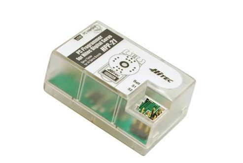

I purchased a servo programmer that works with pc software in order to test and/or set various parameters on certain Hitec digital servos I now own. I did so because it was only a little over $25 and I thought it might come in handy someday.
Anyway, I downloaded the software, connected the programmer to my pc via a usb cable, and to a 4.8volt pack and one of the digital servos, and tried it out.
I first ran a test sweep and then a test automatic step from end to end. The programming features are travel speed, direction, end points and center points, failsafe on or off, all things I can do with my radio. It can also do a few things the radio can't, or I don't think so anyway, for example, resetting to factory specs, and dead bandwith setting.
The instructions say the programmer can be used to burn in a servo and to check for broken gears. How are these done? What is burning in a servo and how useful is it? How would one check for broken gears beyond just listening and watching for clicks/gaps in the rotation?
Thanks.

"Burning in" (which in my opinion is pointless) is just hooking it up and putting in test mode and letting it run back and forth for a while.
To check for broken gears put your finger on it and give it light resistance while it's sweeping back and forth. It will feel gritty or the arm will skip if there's a torn up gear or gears.

Burning in a new servo? Now there's a novel idea.
No, you don't need to do that.
Those devices are great for centering servos and finding the servo movement range, but burning in a servo?

Maybe it should be called "testing" a new servo. I guessany possible earlyfailure mode would only show up when it is subjected to vibration and flight stress variables (unfortunately this is only practical in the actual aircraft!). Simply running it back an forth seems more like a simple pass/fail test. I like the proposal for checking gear damage before deployment, though.

This thing is probably a gizmo that minimum wage "techs" use to QC servos with before packaging. A guy from the marketing dept. saw it on his way through the plant, a light went off in his head and it has now become another one of those "must have" gizmos for the public.

...or it could be a pretty cool tool to set points, throws, and other things on servos, especially for people without the most expensive radios. This thing works fantastic for things like dual elevator servos, or if you don't have individual servo endpoint adjustment on certain channels of your radio.
My hypothesis is that 'burning in' is a layman's term for testing the servo through it's full range of motion to ensure smooth, lubricated travel.

I myself am a beginner, just started flying last season anyway, and I think this thing has some useful functions, even for a beginner. Not a requirement but neither is something as basic as a starter over a chicken stick. It's good to be aware of anyway, in my opinion.

Capp I bought and used the same programmer. I set up my Yak with the Hitec programmable 7955 servo's. Let's you set Dead band, servo speed, fail safe, change rotation and overload protection for the digital servo's. Worked great for me. Good luck with the new plane.
