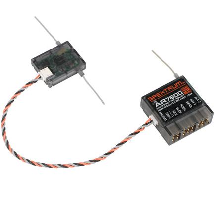

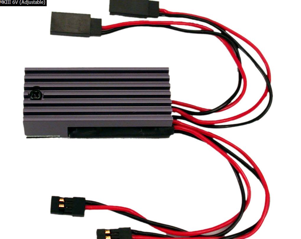

I'm ready to install a regulator for the first time. I have a lithium ion battery, a regulator, and a JR switch with charge jack, plus a Spektrum receiver, links and pictures below.
I plan to connect the battery to the switch, and then the switch to the regulator, and the regulator to the receiver. Is this right? If I connect a charger to the charge jack this way, will it be okay?
Also, I've never done this before and have extra wires on the regulator. Do I just leave the extra ones dangling? Any help would be appreciated. Thank you.

The TBM website description of that item covers the extra wires on the regulator.
So yes, those extra wires are just that, extra. Use a zip tie to tie up the wires neatly and tuck them out of the way inside of the fuselage.
As far as charging, no you will not be able to charge through the regulator. You will need to unplug the battery and plug it directly into the charger. This is best anyway when dealing with a Lithium chemistry battery as the charge currents can be high depending on the size of the battery. You'll want to install it in the plane so that it's easy to access so you can unplug it and charge it directly. Now I know there are some that will say that it's not necessary, but I prefer to be safe and I would completely remove the battery from the plane to charge it. I place all lithium batterys such as this in a Lipo-sack when I charge them so if the battery does vent and catch fire it won't burn down my truck and my house. Also, Li-po's and Li-ions should never be left unattended when charging. But as I said, some will say they charge in the plane all the time with no problems. But to me it's not worth risking losing my plane, my car, or my house to save the couple of minutes it takes to get the battery out of the plane.

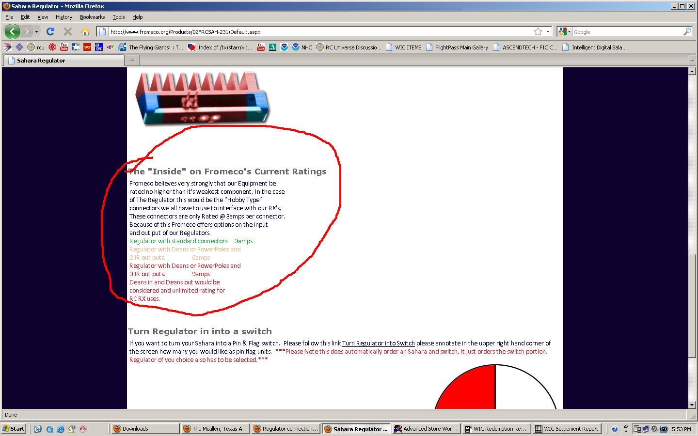

those extra wires could be used as outputs to deliver more current to receiver if you have a vacant channel... each pig tail connected can deliver about 3 more amps ...for example i have a fromeco badger switch with dean in connected to a 5200 battery via deans connector...the output of the switch is deans connected to the sahara regulator with 2 jr outputs both connected to receiver..

Like I said above, it explains on the product page for the regulator what the extra wires are for. Basically they are for 2 battery input and 2 receivers
