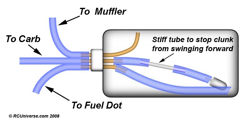

i've ran almost 9 tanks thru the Magnum XLS 46 (breaking in). I adjusted the High Needl first and not much with the Low needle. I get a smooth transition from idle to Full Power. I can point the prop straight up with full power with a noticeable increase in RPM. I can point it straight and back up and the engine still runs.
I then decided to simulate what would happen in the air. At full power I I pointed the prop straight up and then cut the fuel to quarter stick. engine running fine. i then pointed it down 45 degrees less than quarter stick and then increased throttle at horizontal. the engine stuttered and then died. I repeated this a couple times and noticed it happens only when I point the prop down and then straight again.
Could it be the clunk not reaching the front of the fuel tank while nose down? If so, what do I do? or this doesn't happen in flight?

The others are correct in that you don't want the clunk going to the front of tank. If the clunk goes forward many times it will get stuck there and then your engine is going to die as soon as the clunk will no longer be under the fuel. Agood way of preventing this is to simply put a piece of brass tubing in the clunk line so that the clunk will no longer be able to move to the front of the tank.
