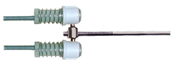

Hi, I am building a plane with two seperate sides the the elevator. Each side will have its own control horn and rod. I will only have one elevator servo.
I want to use a solid connection to the servo, like a z-bend.
How can I attach two control rods to one servo with a solid connection, like a z-bend?

Sullivan Double Ball Joint about halfway down the page:
http://www.sullivanproducts.com/ContSysAccMainFrame.htm

Thank you. For the Sullivan part, how to the control rods attach? If I have the threaded end of a control rod down at the control horn and the non-threaded end up at the servo, how to that attach to those two springy things? thanks

You'd probably have to use soldered on threaded couplers for the ball link ends. You fit them over the plain end of the control rod and solder them on.

The springy things are glass reinforced nylon sleeves that have either 2-56 or 4-40 female thread.

Just bind and solder a short length of 4 40 threaded rod to the two push rode and you have the joiner. (see pic)
Cheers
