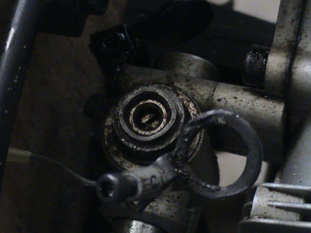

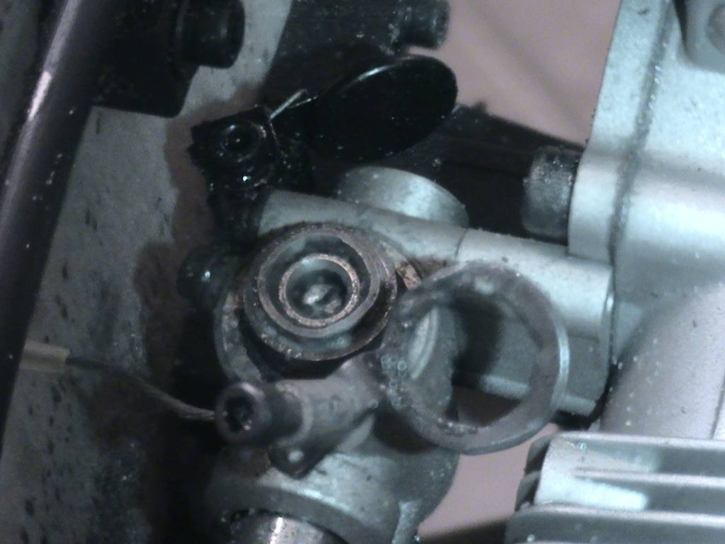

i recently picked up a 4 stroke bi-plane for cheap. i'm goin through it right now and came across this. what do i do about this. please help. i dont know what you would need to know, so if there are questions please ask and i will try to answer them.

here is another picture

here is another. thanks for any help

Old 02-13-2010 | 06:07 PM
RCKen's Avatar
RCU Forum Manager/Admin
Posts: 28,241
Received 31 Likes on 27 Posts
From: Lawton, OK
Default RE: cable to carb???
If I understand your problem correctly it's that the carb sits too close to the firewall to connect to. This is very common with 4-stroke engines. Here is how you take care of that issue. First replace the cable with a stiffer pushrod. Then exit the pushrod out of the tube and bend it back around to the throttle arm.

First, it looks like you need a new throttle arm. I've not had good luck trying to salvage a broken arm like in the photo. You can get them at tower.
Iuse a like cable linkage, but I usualy have a ball on the throttle arm and have my adjustable screw on the servo. Your setup will let you get the throtle arm as close to the firewall as possible. My setup add's about 5/16" to 3/8" but I'veyet to find a situation that It didn't work.
My suggestion is to replace the throttle arm and the cable, The cable sheith may be OK, but you will never save that bent up cable.
A question, was the plane wrecked? I can under stand the arm breaking off the the servo was over travelling and it was binding at full throttle and full idle. I can't get my head around what may have bent the cable like that in the first place.
Don

Will I need a new carb or is the arm a separate piece that is available.
Old 02-13-2010 | 11:55 PM
Joined: Feb 2006
Posts: 4,465
From: Arroyo Grande, CA
Just the arm. The hub is held on with a set screw and the arm was attached to the hub. It should be almost a painless repair. They are under $10, and should ship for just a buck or two more.

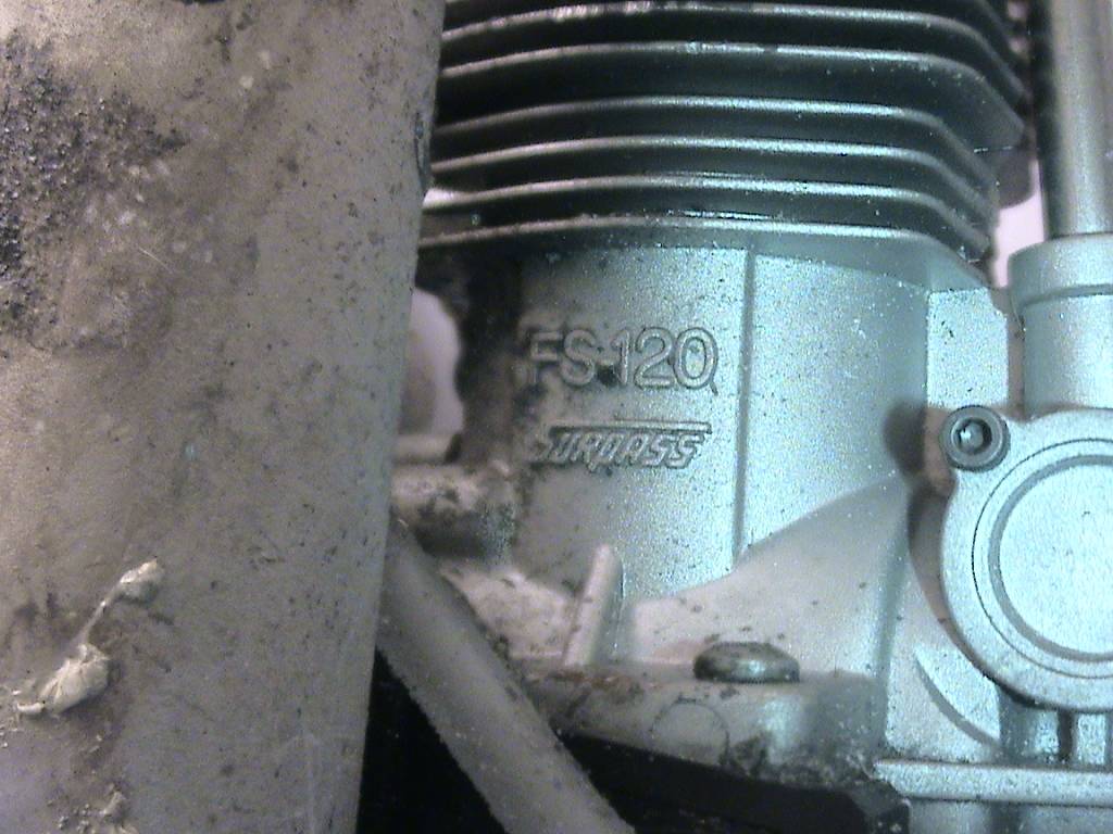

Old 02-14-2010 | 01:14 PM
Joined: Jan 2008
Posts: 52
From: Palm Bay, FL
this is the engine that i have
Old 02-14-2010 | 02:08 PM
GaryHarris's Avatar
Joined: Sep 2008
Posts: 2,101
From: Houston, TX
Hopefully its just an illusion, but it looks like your crankcase is cracked.

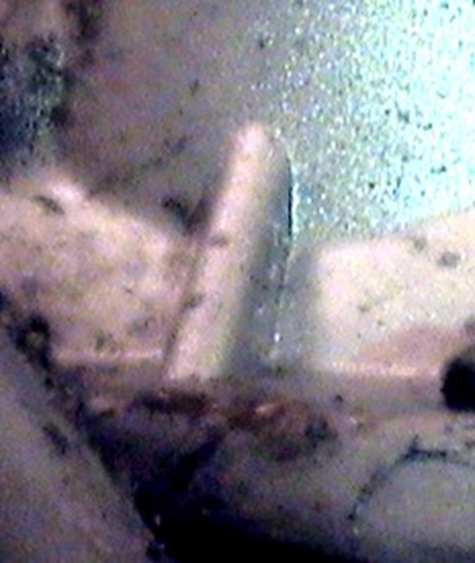

Old 02-14-2010 | 02:14 PM
GaryHarris's Avatar
Joined: Sep 2008
Posts: 2,101
From: Houston, TX
It definitly looks like a crack.

Old 02-14-2010 | 02:21 PM
My Feedback: (-1)
Joined: Apr 2003
Posts: 14,400
Received 9 Likes on 8 Posts
From: Hemderson, NV
Just a broken throttle arm, I broke one once and it was just ordered from my LHS or Tower. If that is a small crack?? It can be repaired by cleaning it good with acetone then mix up some JB Weld, heat the case and heat the JB then with a finger push in the JB and let cure over night. JB Weld can save a lot of little things like that.

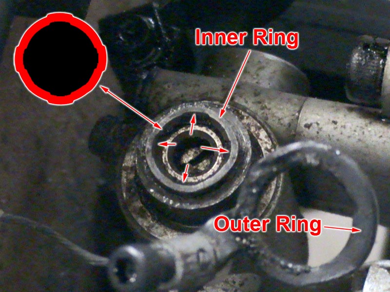

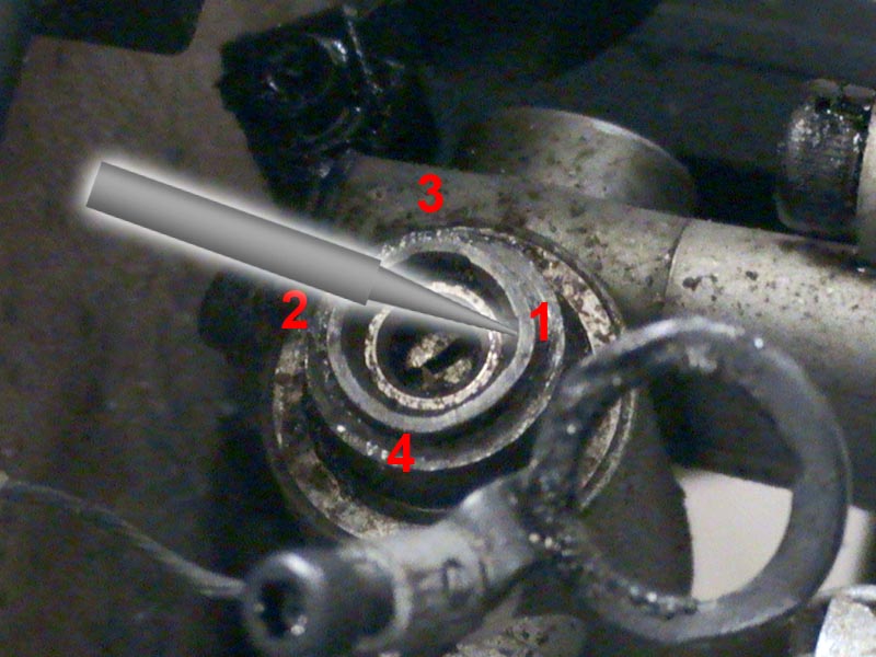

First off, that's not a crack. It's just a ridge left by a seam in the mold.
Second, you can easily repair that arm.
The arm is pinched in place and yours has not broken, it has just come loose.
Note how the inner ring has 4 indentations (Picture 1). This is where the ring was mechanically pushed out to squeeze itself against the outer ring.
Put the outer ring back in place and tap the 4 indentations on the inner ring with a punch to push them out against the outer ring and you'll be fine (just make sure the arm is in the right position first).

Old 02-15-2010 | 05:56 PM
Joined: Feb 2006
Posts: 4,465
Mike, take a close look at the ring in your second photo, It looks like it has been bent and twisted. Note that the arm is not coming off it square, but has been twisted. It looks like it has had some serious plier work on it. $4.95 is cheep insurance.
That style arm loosens up some times. Itake it off the carb, and use a small screwdriver as the punch and drive the flares back tight in the notches on the arm. My O.S. 52 four stroke has the same type arm and I couldn't figurre why the engine was not consistant around idle. I then noticed that the ring was chucking agack and forth on the hub. Loosen the set screw and then tighten thingsup on the bench block and you are good for another season.
I'm not a fan of using the punch on the throttle arm while it is still on the carb.It would be to easy to sip and cause some reall damage.

Old 02-16-2010 | 10:27 AM
GaryHarris's Avatar
Joined: Sep 2008
Posts: 2,101
From: Houston, TX
Photography is one of my other hobbies. I saved the pic and played with it some using post processing software. Check this look.
Old 02-16-2010 | 10:39 AM
MinnFlyer's Avatar
Posts: 28,519
Received 9 Likes on 9 Posts
From: Willmar, MN
I saw that. It doesn't look like a crack. I am a digital imaging specialist and I also used to be a metallurgist and dealt with foundry castings often. It looks like a minor flaw in the casting, but nothing to be concerned about.
